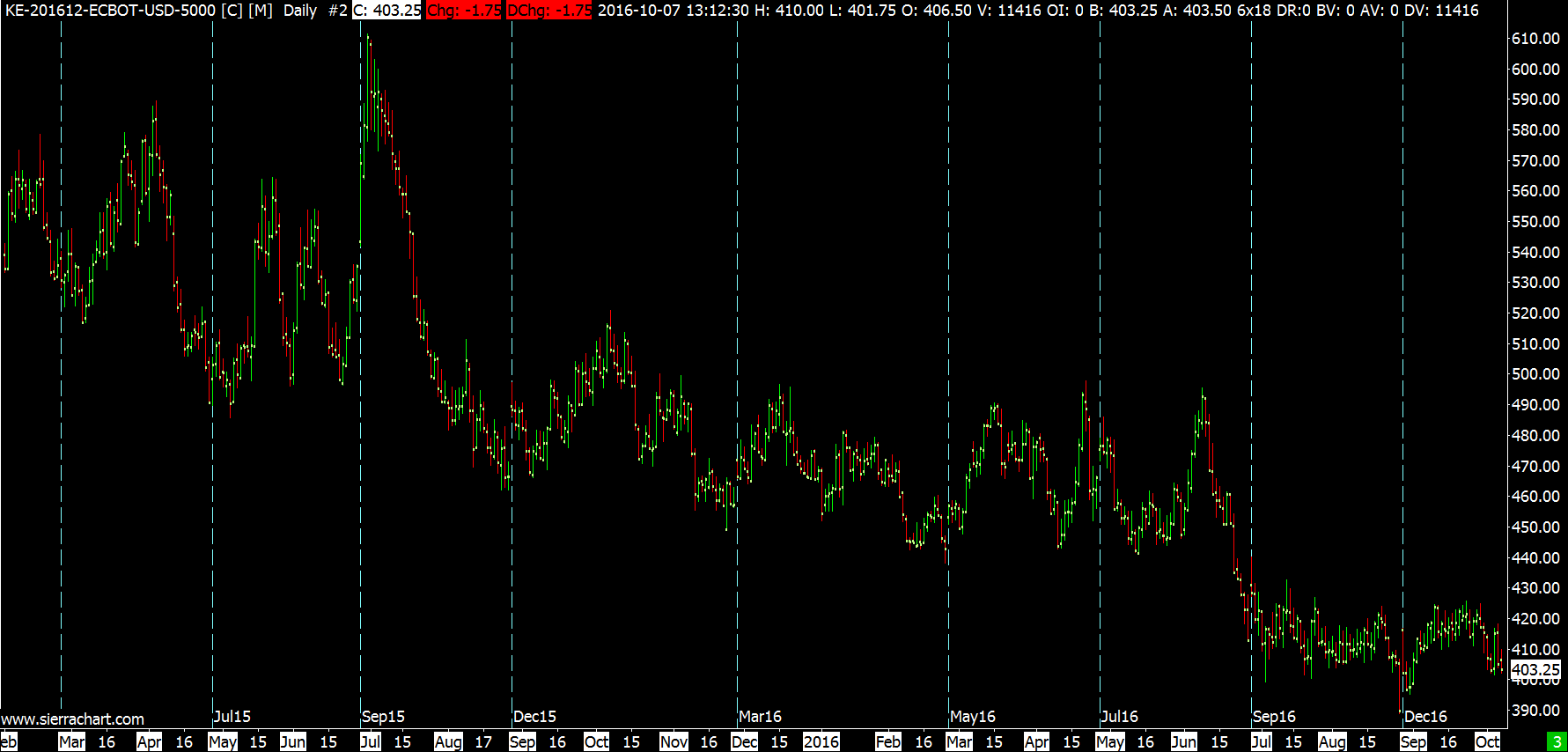

It works fine for us:
http://www.sierrachart.com/image.php?Image=1475860373519.png
Follow the instructions here to delete the KE* daily data files:
https://www.sierrachart.com/index.php?page=doc/ContinuousFuturesContractCharts.html#ReDownloadingByDeletingFiles
