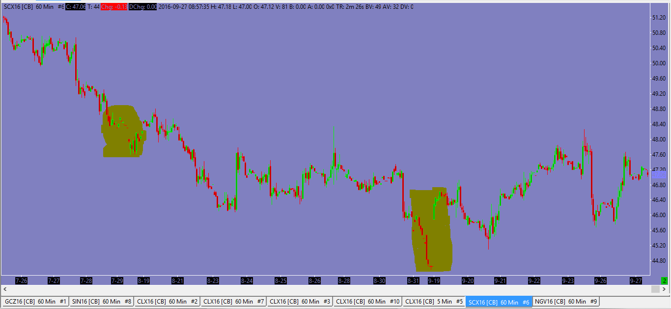

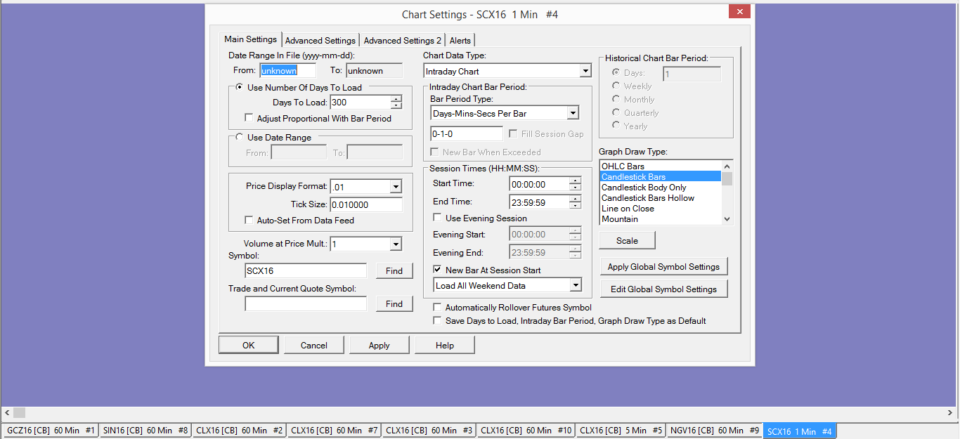

I opened a new chart of Crude Oil Brent- NYMEX (SC) But some of the chart data is missing for example, from 1st till 18th Sep 2016. I have attached the screenshot of chart and chart settings. I am using the updated version of the software.

[2016-09-27 17:44:57]
There were two problems with the settings for the symbol.
They have both been corrected. Update the Symbol Settings as explained here:
Global Symbol Settings: Update Symbol Settings
The next step is to re-download all the data in the chart:
https://www.sierrachart.com/index.php?page=doc/ContinuousFuturesContractCharts.html#ReDownloading

I have gone through the process explained in the above two links and at chart was downloading the data but then nothing appeared. The whole chart is blank. I tried restarting the software, re-downloading the data, etc but no joy. The charts are working fine but only the SC chart doesn't seem to show any data. I have attached the screenshot of the chart settings.

[2016-09-28 00:07:18]
That actually is not the correct symbol for what you want.
The underlying symbol is QA. Use this. It is listed under File >> Find Symbol >> Futures -Energies
First update the symbol settings as explained here:
http://www.sierrachart.com/index.php?page=doc/GlobalSymbolSettings.php#UpdateSettingsSteps
