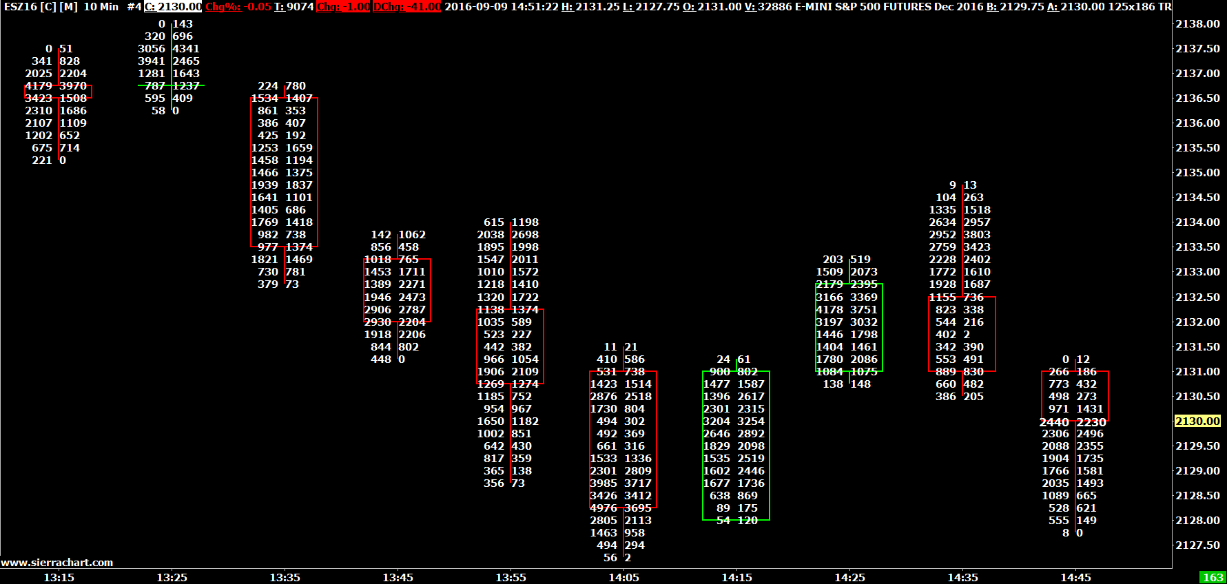

when adding Numbers bars, i can generally get the open/close box to appear which looks great.
Looking to create something like this - https://dl.dropboxusercontent.com/u/9913454/tmp/numbers-bars-with-candle-outline.png
The rectangle in the image is drawn by Numbers Bars - the wick is done by hand.
It there any way to get the wick as well (like in the image)?
[2016-09-09 18:52:17]
This is not directly supported be can be done by using the Overlay (Bar) study:
http://www.sierrachart.com/image.php?Image=1473447086202.png
The Graph Draw Type is Candlestick Bars Hollow. We can give you an example Chartbook if needed.

[2021-11-23 15:35:25]
David Elstob - Posts: 10
How do I move the overlay bar to column 1 please? Presently it is centred between column 1 and 2.
Can't seem to find out how to justify/move it. Thanks.
[2021-11-24 15:32:30]
You can not move the position of the bar from the Overlay study.
The only other option is to use the Bar representation items within the Numbers Bars study itself. Refer to the information starting at the following link:
Numbers Bars: Open and Close Marker Style
[2021-11-28 23:58:33]
Worked perfectly, John, thanks.
