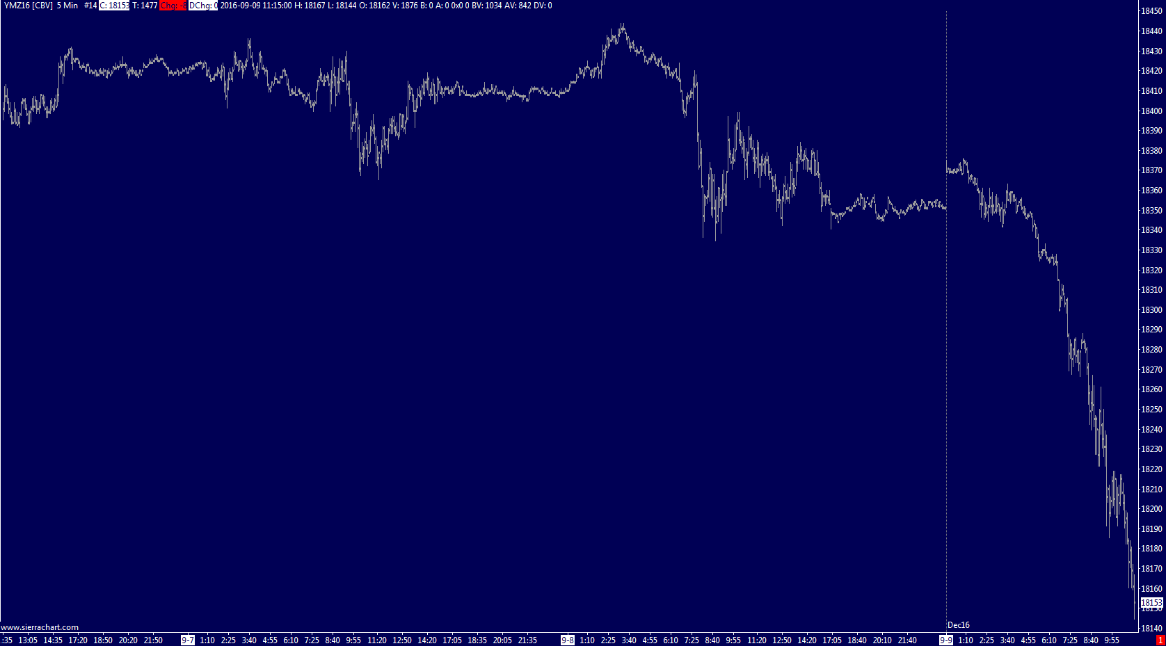

Hello, after the rollover i have wrong yesterday data in intraday chart ( YM and NQ) if i use continuos futures contrant - volume based rollover back adjusted. But the data is correct if i use "date rule rollover buck adjusted"
i have did edit > delete all data and download but the problem remains.

http://www.sierrachart.com/image.php?Image=1473442736431.png

Refer to this page for how the back adjustments are done:
http://www.sierrachart.com/index.php?page=doc/ContinuousFuturesContractCharts.html#ControllingRolloverAmount
Here is the actual data:
YMZ16 [CBV] 10 Min #1 | Performing continuous futures contract back adjustment calculations. | 2016-09-09 14:18:13
YMZ16 [CBV] 10 Min #1 | YMU16 Open price on 2016-09-09 is 18455. | 2016-09-09 14:18:13
YMZ16 [CBV] 10 Min #1 | YMZ16 Open price on 2016-09-09 is 18351. | 2016-09-09 14:18:13
YMZ16 [CBV] 10 Min #1 | YMU16 price difference to YMZ16 is -104. | 2016-09-09 14:18:13
YMZ16 [CBV] 10 Min #1 | Back adjust amount for symbol YMU16 is -104. | 2016-09-09 14:18:13
What you are seeing is completely correct.
One thing that will help is to adjust the Session Times to the actual session times for that particular futures contract. Refer to:
http://www.sierrachart.com/index.php?page=doc/SessionTimes.php
For the session times to be used in the rollover, you need the latest version.:
http://www.sierrachart.com/index.php?page=doc/download.php#FastUpdate

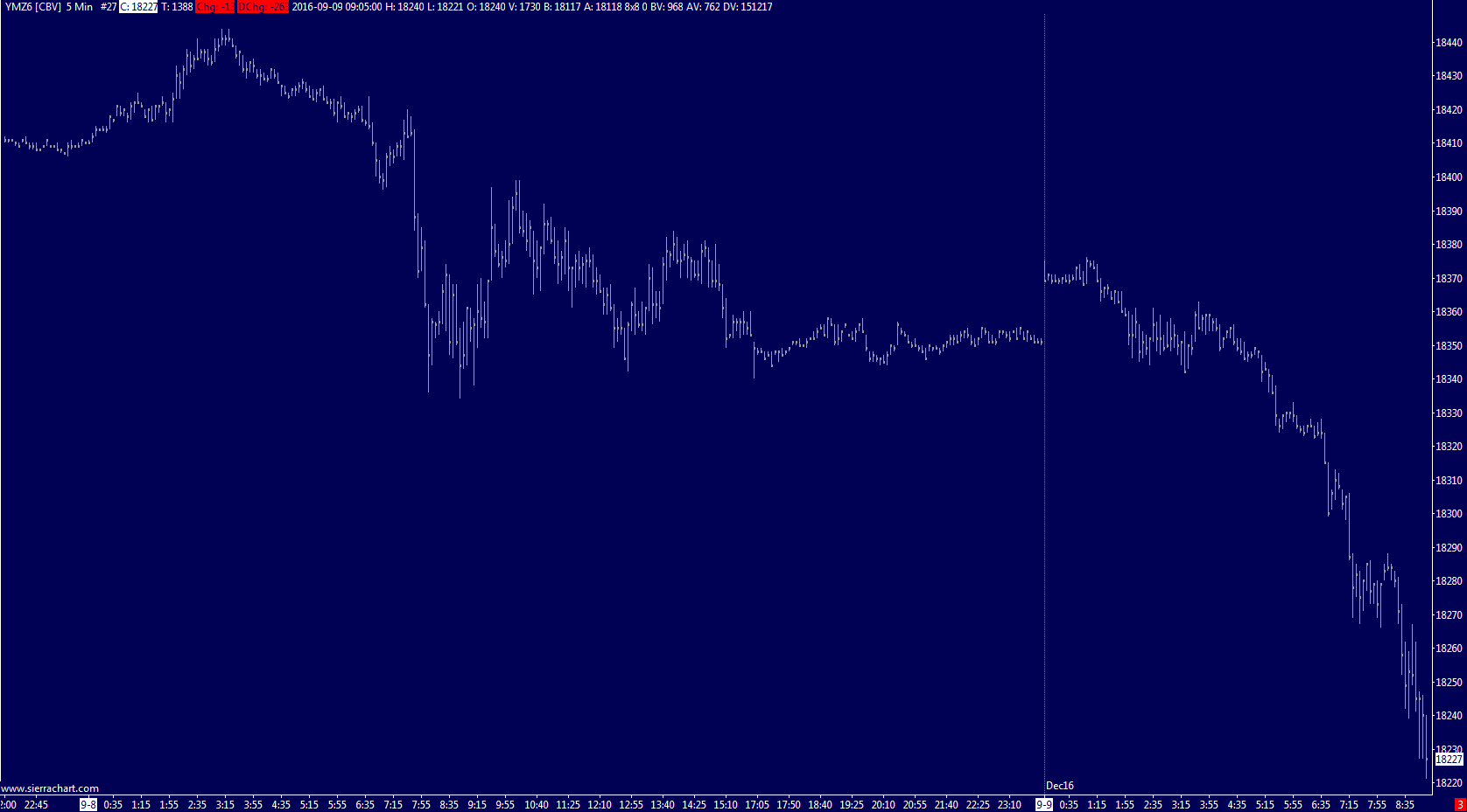

But how can i adjust my chart (see post 3) ? Because it is not correct when i use continuos futures contrant - volume based rollover back adjusted. But the chart is correct if i use "date rule rollover buck adjusted"
http://www.sierrachart.com/image.php?Image=1473667703242.png

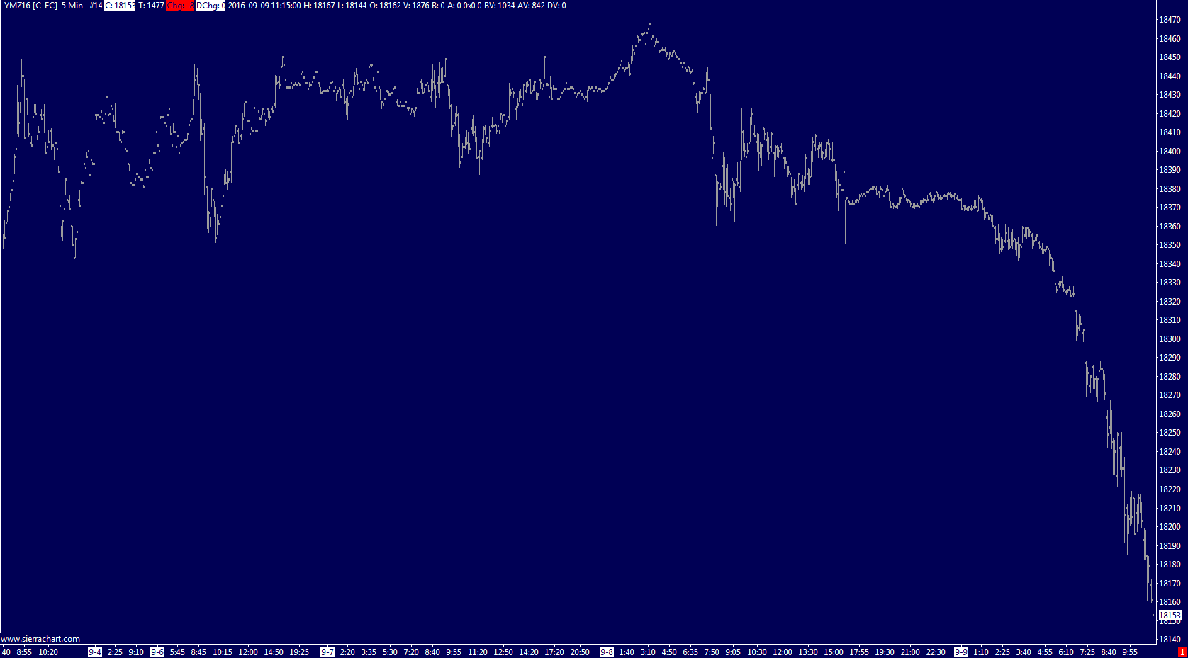

forward curve
http://www.sierrachart.com/image.php?Image=1473667807727.png

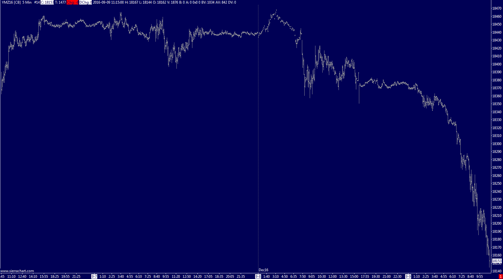

http://www.sierrachart.com/image.php?Image=1473667851962.png

start time: 00:00:00
end time: 23:59:59
time zone: Chicago(-6CST/-5CDT)
Date Time Of Last Edit: 2016-09-12 08:14:35
[2016-09-12 08:21:46]
This is what we have been saying. You need to use the actual Session Times:
start time: 16:15:00
end time: 16:14:59
You need to update Sierra Chart to the latest version with Help >> Download Current Version.
