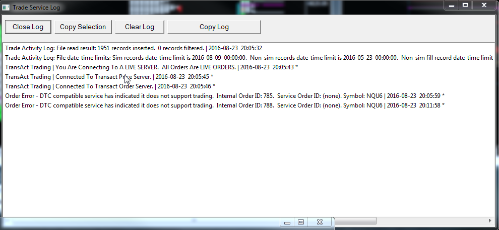

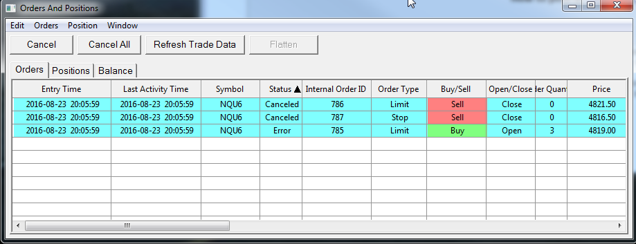

[2016-08-24 00:13:30]
User488039 - Posts: 114
I previously had Trade >> Trade Simulation Mode On, then I disabled it. Then it said click ok to trade live, I did. The log then said I was connected to TransAct data server and order server.
Then I place a buy limit order below the current price, and the order is immediately cancelled before it's placed. Also, under the Balance tab, it is completely blank.

[2016-08-24 01:40:10]
We just now realized what the problem is.
Reconnect to the data feed again and you will be able to trade.
