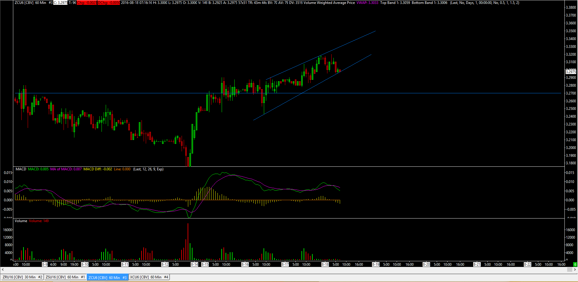

I'm trying to add VWAP as a study to a chart.
Although the study seems to be added and the VWAP is displayed as a number at the top of the chart, the VWAP lines are not drawn on the chart.
I have tried moving the study to other regions but it does not draw on these regions either.
Screenshot attached, seen VWAP number posted at the top but no line drawn.
Any help would be greatly appreciated.
Many thanks,
George

[2016-08-18 17:59:24]
Follow through the instructions here to reset the Volume Weighted Average Price study to default:
http://www.sierrachart.com/index.php?page=doc/ChartStudies.html#CustomDefaultStudySettings
After that is done remove it from the chart and Add it again.
