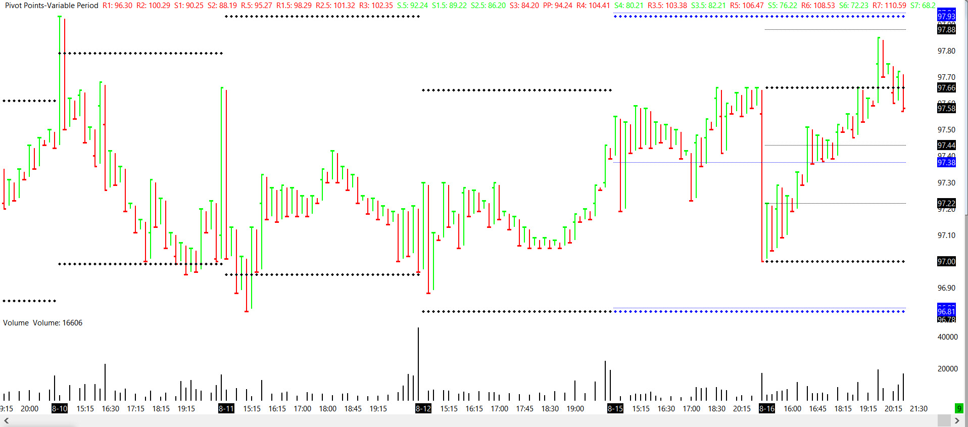

Can anyone show me the direct path to add?
I try following two way, but none is my need.
1. Chart → Chart Settings → Graph Draw Type, choose "Point and Figure XO"
2. Analysis → Studies → add "Point & Figure Chart" into Studies to Graph:
What I want is like your example as attached.
Thanks,
Fanhow

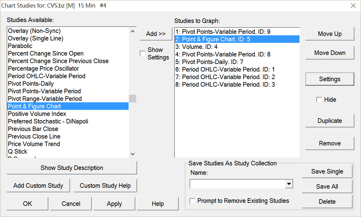

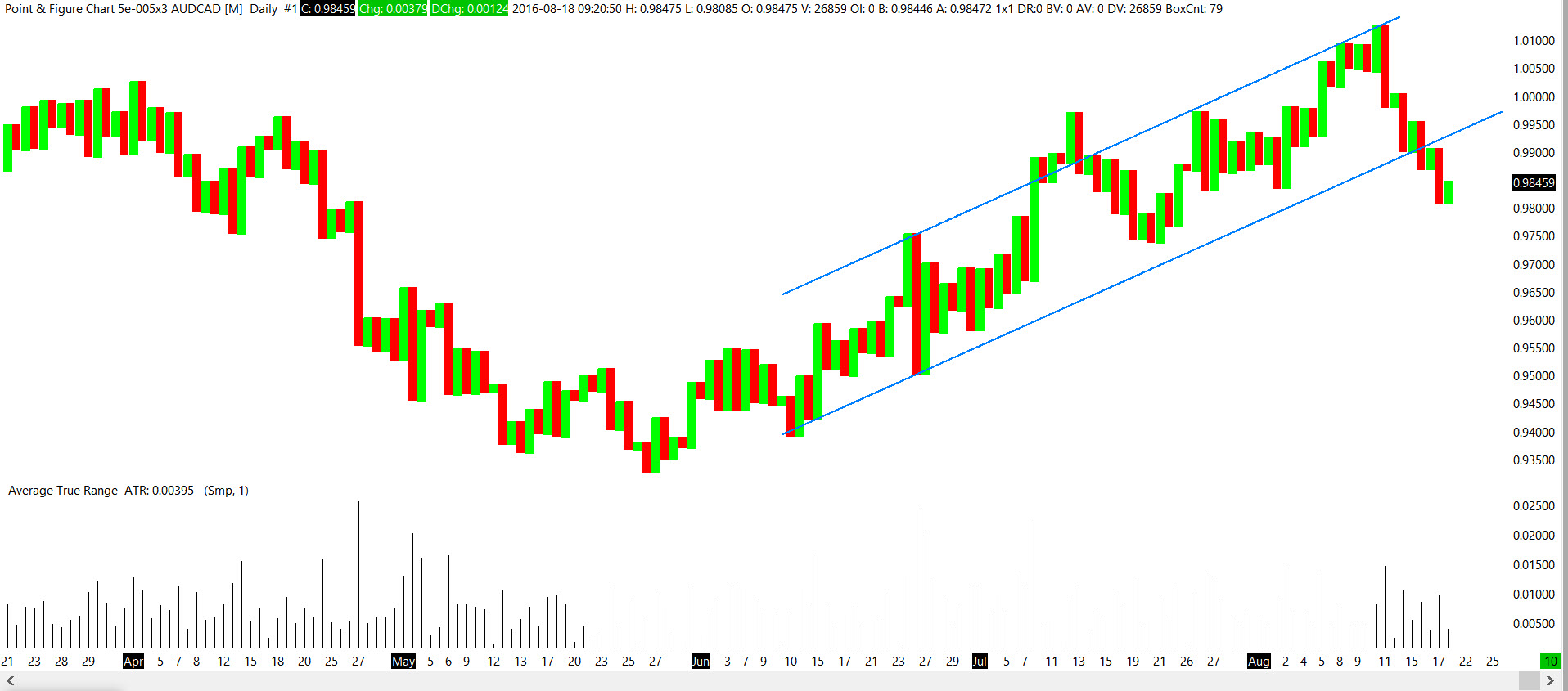

User349605 - Posts: 11
I do add the Point and Figure Chart study to the chart, as attached "2.jpg".
However, my chart is changing to "3.jpg", not like your sample showing as O/X (1.jpg).
How come?

[2016-08-17 20:29:47]
Refer to the instructions here to change the Graph Draw Type for the study:
http://www.sierrachart.com/index.php?page=doc/TechnicalStudiesReference.html#ScalingPointAndFigureChart
