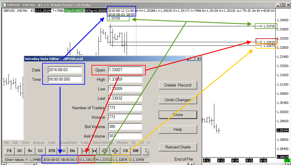

I have noticed that different values are presented by the 'OHLC Ray Tool' from those given in the SC Header-line Chart Values; Chart Values for Tools (Region 1; Chart Values Window (scrolled to the test bar).
The same issue occurs with the 'Swing Marker Tool' however as it requires a minimum 2 bars you need test either 2 bars. This tool gives the same value as the 'OHLC Tool' which again is not the same value as is given in the SC Header-line Chart Values; Chart Values for Tools (Region 1); Chart Values Window (scrolled to the test bars).

[2016-08-13 11:29:38]
User92573 - Posts: 619
Here is corrected image.
