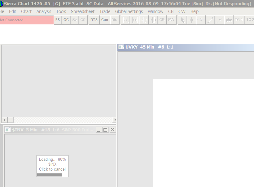

TraderTen - Posts: 80
I had a bad dll once that caused my chart books to freeze up upon loading. I cleared that issue up. This, I think could relate to number of charts in the CB: around 50, plus many may have been set to too large a number of records to download.
However, I have a pretty capable PC, and have never had this issue in all the years I have used SC. I could not get the log file as it was frozen also. Any ideas?
Private File
imageFrozen program.PNG / V - Attached On 2016-08-10 07:11:05 UTC - Size: 28.9 KB - 424 views
[2016-08-10 07:40:12]
We think we might know what is causing this. It could be due historical data corruption over the network causing a large number of messages added to the Message Log. The excessive number of messages added to the Message Log issue has been corrected in the latest release.
Run the Sierra Chart installer:
https://www.sierrachart.com/downloads/SierraChartFileDownloader.exe
Install the current version into this folder: C:\SierraChart\
Now what is causing the data corruption we do not know, but once you get the update done we can analyze that further.
