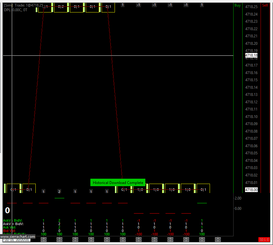

Hello, Sierra since yestersday is slow (every act takes 60sec.) and mostly not Responding. Chart is not moving at all.
Strange things happenning on NQ (AMP / CQG). NORMALLY on upper-left is 1sec.NQ with Ask/Bid Volume (just black and no lines), lower-left is 15sec.NQ with Delta, in middle is NQ 2mins. Numberbars, and on upper-right is NQ 2min.with Volume profile. Rest is normal. Dont know what to do with it.
Regards
Miroslav
http://www.sierrachart.com/image.php?Image=1470244564753.png

Well. Thought picture will be from whole screen. Picture posted is as the discrabed as middle one - as Numberbars (Footprins).
[2016-08-03 17:42:56]
Select File >> Disconnect.
Update the Symbol Settings as explained here:
Global Symbol Settings: Update Symbol Settings
Go to each chart and apply the Symbol Settings as explained here:
Global Symbol Settings: Update/Apply Symbol Settings to Charts
Go to the chart that you posted an image of and select Edit >>Delete All Data and Download.
Select File >> Connect to Data Feed.
Date Time Of Last Edit: 2016-08-03 17:43:32
[2016-08-03 22:45:19]
Please confirm whether the above instructions solved the problem for you. We were concerned about what we saw in that chart with the timescale having just repeated zeros in it.

[2016-08-04 07:43:07]
User347225 - Posts: 8
Thank you. Was necessarily to follow process twice. Now it looks fine.

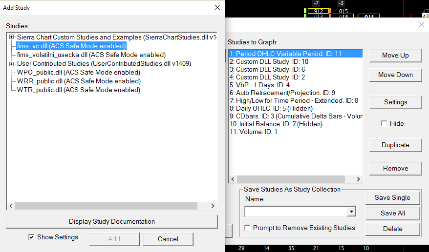

My DLLs are visible in Add Study. But when my study is Highlighted than "Add" button is grey and death (no chance to click on).

[2016-08-19 09:48:17]
We need to understand this better.
Provide a screenshot of the Add Custom Study window showing what you see.
Here are instructions:
[2016-08-19 10:15:35]
User693138 - Posts: 20
It again changed.
Now in Normal Mode (pic#1) some Added DLLs works. Did not try all.
In Safe mode (pic#2) NONE of them works. Vwap is not working in safe mode to.
imageNormal Mode.png / V - Attached On 2016-08-19 10:13:43 UTC - Size: 39.38 KB - 338 views
imageSafe Mode.png / V - Attached On 2016-08-19 10:13:57 UTC - Size: 39.43 KB - 351 views
[2016-08-19 10:20:30]
This is not really clear for us what the problem is.
You will need to contact the developer of those studies. We do not see how we can help with this.

[2016-08-19 11:04:30]
Is the problem that when you use that particular study Sierra Chart is freezing? If so, we will look into this.
