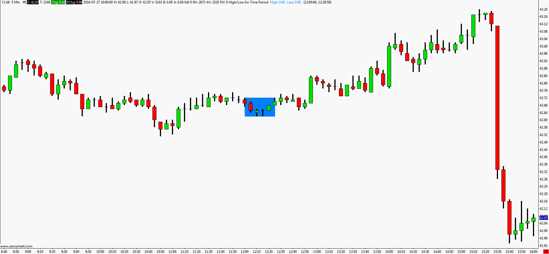

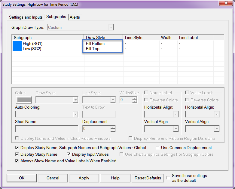

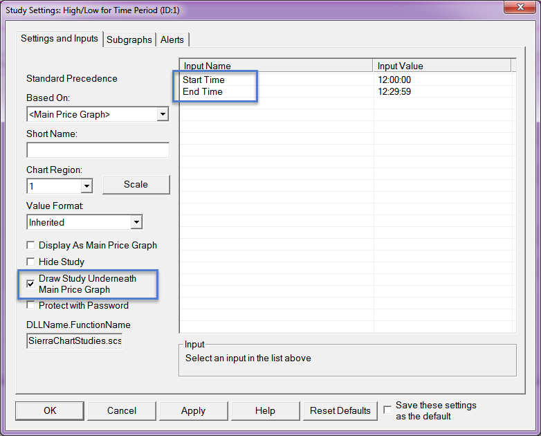

[2016-07-30 18:05:03]
User41683 - Posts: 42
There is something available. Strange the guys from support don't even know.;-)
Use the study 'High/Low for Time Period'.
For settings see the attached files.
imageHigh-Low Settings1.png / V - Attached On 2016-07-30 18:03:09 UTC - Size: 44.44 KB - 771 views
imageHigh-Low Settings2.png / V - Attached On 2016-07-30 18:03:17 UTC - Size: 46.85 KB - 721 views
imageCLU6 5 Min #6 2016-07-30 19_01_39.070.png / V - Attached On 2016-07-30 18:03:54 UTC - Size: 57.46 KB - 798 views
