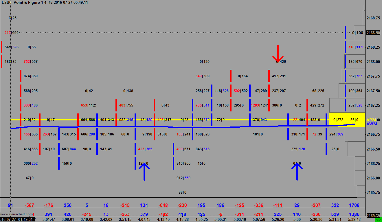

I use a 4 Point & Figure chart in the ES and have noticed at times new bars are created with 3 price levels ticked instead of 4. See the attached image from this morning. I see other charts, like Market Delta, where the Point & Figure turn is at 4 ticks, as I would expect. This sometimes creates a few extra bars that are not needed. Chart settings are 1-4 for Point & Figure, with tick size 0.2500000.
What can be done about this?

When providing an image of the chart use this method only:
Repost the image of the chart. Your chart image is not acceptable as it is because we cannot see the timescale.
We also need to know the Chart >> Chart Settings >>Session Times you are using in the chart.
And we need to know the Time Zone Setting you have set Sierra Chart to:

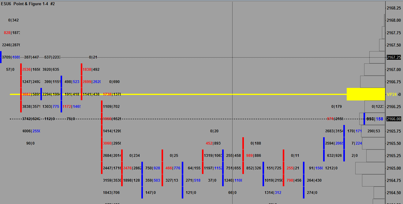

Here is the chart image:
http://www.sierrachart.com/image.php?Image=1469623755884.png
Session Times: Start Time 13:30:00 End Time 13:15:00
Evening Session = NO
New Bar At Session Start = YES Load All Weekend Data
Time Zone Setting = Phoenix (-7 MST)
