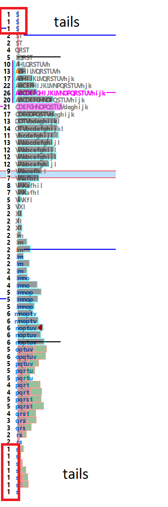

Is it possible for you to add the TPO count on top or bottom of the profile?
above / below POC without tails in reel time
exemple on the chart
imagetpo count.PNG / V - Attached On 2016-07-23 06:11:32 UTC - Size: 21.17 KB - 817 views

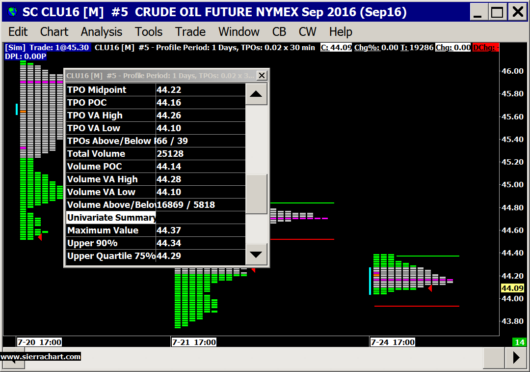

As a general rule that was decided years ago, this type of information will not be displayed on the chart itself. It is only available as documented here:
https://www.sierrachart.com/index.php?page=doc/doc_TPOVolProfileCharts.html#TextInformation

Ok i understand your way but the numbers of TPO are on chart (on the left of the profile) anyway, so i can't see the difference if we can get this option because we can do it with paper it's just easier and no loosing time.
Tails are the top and bottom single print on the profile (see attachment)
and tails don't have to be counted on the TPO count even in reel time during the day
Sorry for my english :)
imagetails.PNG / V - Attached On 2016-07-24 05:47:51 UTC - Size: 28.39 KB - 564 views

Why would you do the calculation on paper? For what purpose?
What you are looking for is already calculated and available here:
We will include a new input in the TPO Profile Chart study named Ignore Singles in TPOs Above/Below POC.

[2016-07-25 05:56:53]
You just need to go to Window >> Chart Values Window on the detached chart. You can size and position it as required.
Here is an example:
http://www.sierrachart.com/image.php?Image=1469426166254.png
