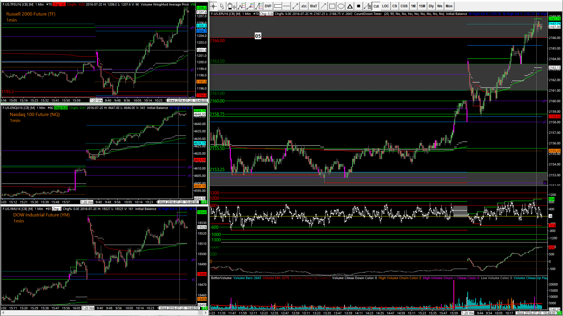

Hello Support,
today the Russell data come in delayed by abt 5minutes.. i am on the latest prerelease (1446), though 1445 did not work either. see screenshot attached with the global crosshair. the latest candle in the russell obviously represents 5 candles (1min chart) earlier from the other 3 charts.
please advise.
thanks,
Andreas
image2016-07-20_10-55-08.png / V - Attached On 2016-07-20 14:58:57 UTC - Size: 136.38 KB - 466 views
[2016-07-20 16:20:45]
We apologize for this issue. Are you noticing a problem currently?
If you still notice a problem reconnect to the data feed using the Disconnect and Connect commands on the File menu.
We do see a problem that occurred on one of the servers with Open Feed resulting in this condition. We are looking into the cause. It only occurred on one of the servers.
If there is any missing data in the chart, right-click in the chart before the missing data and select Delete and Download Data.

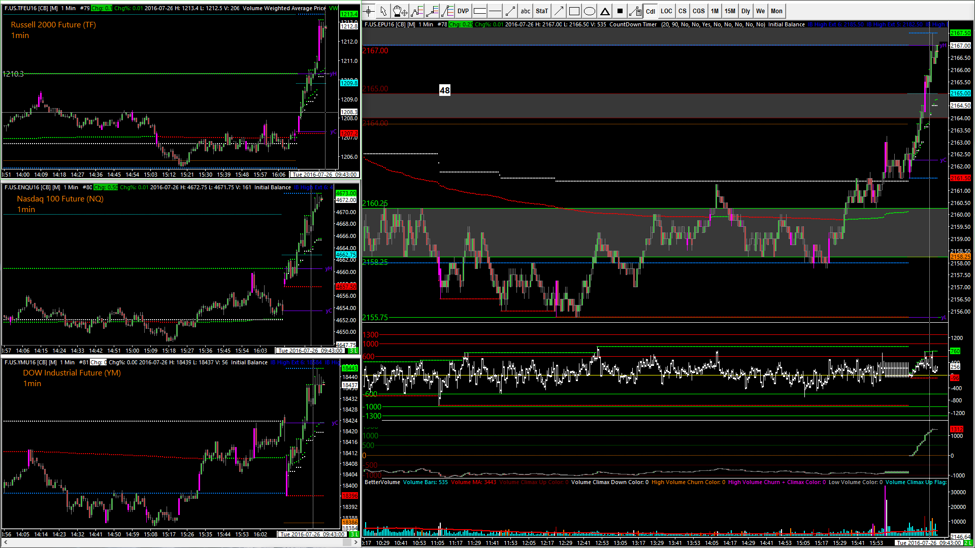

Hi SC,
issue just came back...
how can i force a switch to another server?
thanks,
Andreas
image2016-07-26_09-48-19.png / V - Attached On 2016-07-26 13:48:41 UTC - Size: 133.6 KB - 341 views
[2016-07-26 15:54:35]
You just need to reconnect to the data feed using the commands on the File menu to go to the other server.
Also, this is very puzzling why this is still happening.
We do see evidence of the problem but we have to figure out why it is happening.
Also this kind of chart image is not helpful to us. It is too complicated. It is sufficient just to give us one of the symbols and tell us how much of a delay there is. Instead of us looking at that image and trying to figure out what you are trying to show.
Date Time Of Last Edit: 2016-07-26 15:55:35
