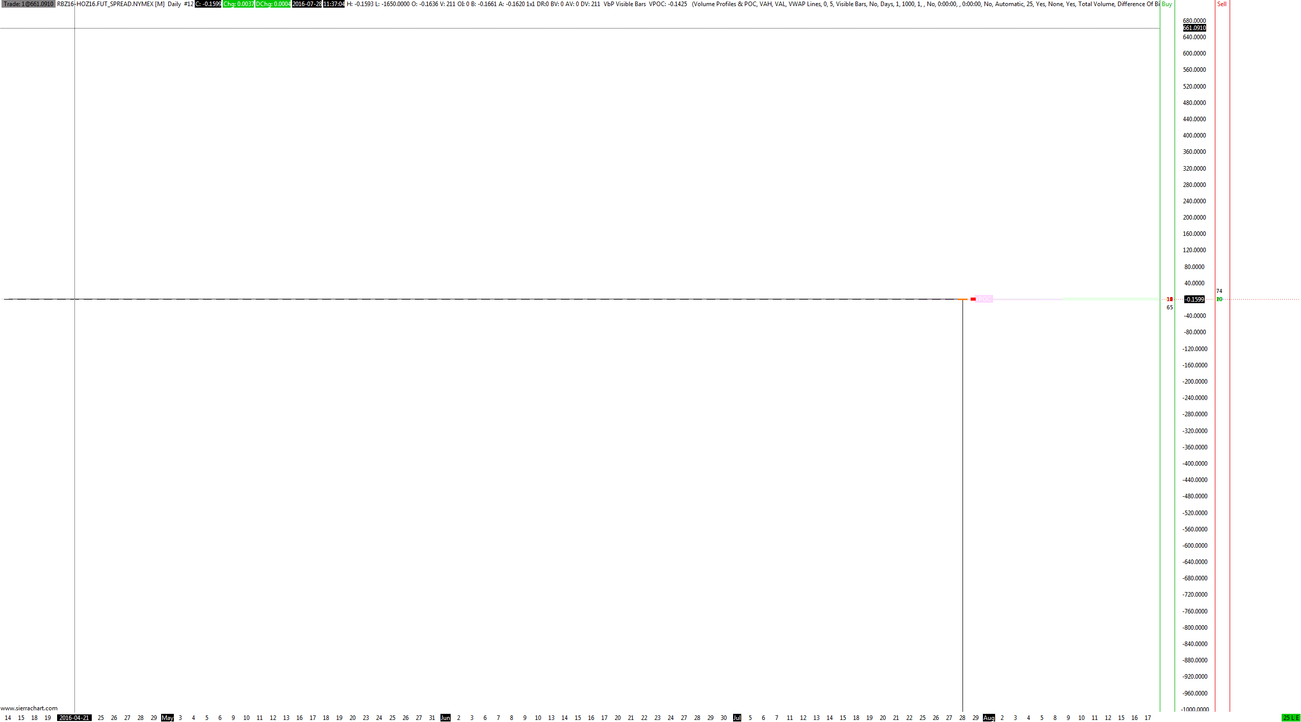

So I think one reason this might be happening is bad data that keeps coming in on this spread. I've deleted the data and redownloaded and the chart is fine again - but I've been seeing this happen quite often this week.

Yes of course. That is indeed the cause of the problem. There was no doubt that it was caused by a wide range of prices in a Historical Daily chart.
We checked the data on the server for that symbol, and the data error does not exist. Maybe it existed temporarily but that does not really seem to make sense. If it did, the origin must be from the CME feed itself.
So not quite sure why the error is happening to begin with.

i960 - Posts: 360
So sure enough - it happened again less than 3-4 hours after deleting the data and redownloading. The only thing I can even think of, event-wise, would be disconnecting and reconnecting - but this spread data isn't even coming from my broker, it's coming from SC.
An interesting thing though is that if you look at the "low" price for this errored bar it's exactly 1000x off from the low of the last bar (which was -0.1650). The problem bar has a low of -1650.0. I feel this isn't a coincidence and there's some kind of connection to this problem.
Okay yes, indeed. I *just* reproduced the problem. When I disconnect and reconnect from within SC, boom the bad bar is right back on the chart after I had *just* redownloaded the data before disconnecting. There has to be a bug here.
Video of the reproduce case (this is the 2nd time in a row I reproduced it as well): https://youtu.be/bvHZndqEIWM

[2016-08-02 05:25:49]
This is now fixed in the latest prerelease:
