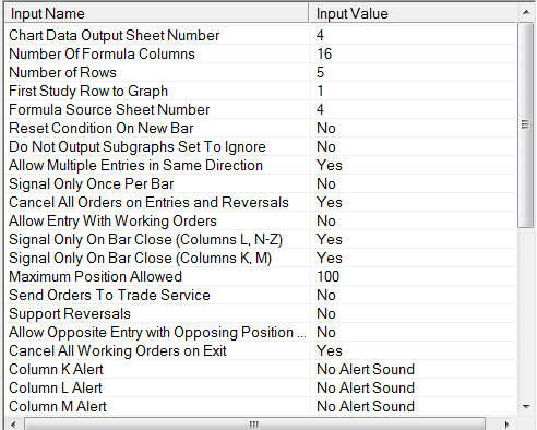

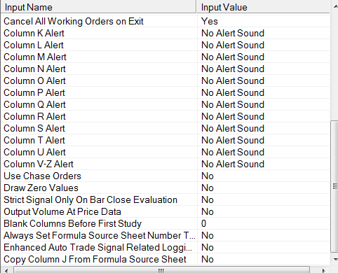

sc, for the sake of my sanity, after trying various study input settings I am appealing to your knowledge once again and anyone else who can help me regarding backtesting with multiple charts and study settings. I am using a spreadsheet system for trading study. I have three charts to backtest(long-term,mid-term,entry) and from each I have the output data allocated to an individual sheet. The long-term chart output sheet is used for the entries and exits while referencing the other output sheets respective of secondary and tertiary criteria. My challenge is to understand why my entries(stop-limit +/-1) fail, after meeting all criteria, to be filled close to the entry chart's last completed candlestick as well as why each entry candlestick is not entered though the input study is set to multiple entries and up to 100 contracts. The exit criteria fails as well.

Screenshot attached of long-term chart's study input settings.
