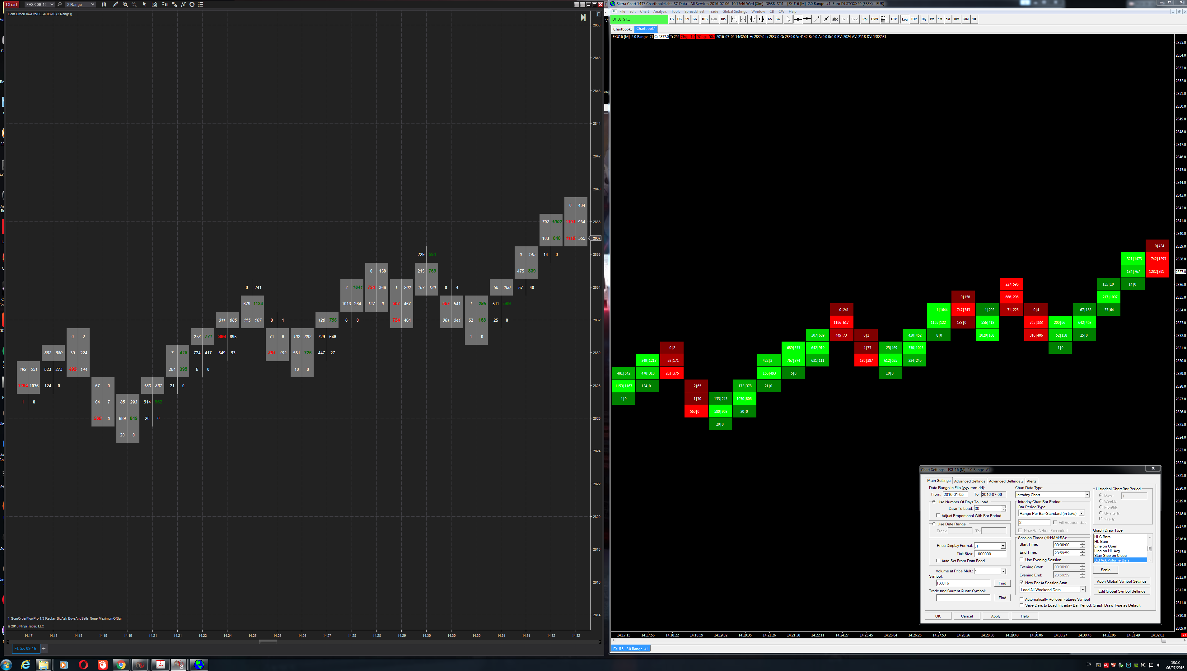

i have a question about the sierra feed.
Iam new to Sierra, have checked all settings and also used the "delete and download data" link several times but if i check the data with kinetick there are differences to large.
My main interest is Eurostoxx, did not check any other instrument.
Any other people use the Sierra feed with eurostoxx ?
or does everyone use IQfeed ?
Sidenote: ofcourse Kinetick can be wrong.... will try to verify this but have to find someone who uses IQfeed.... (or other feed)
Date Time Of Last Edit: 2016-07-07 03:18:30
imagesierra-NT8.png / V - Attached On 2016-07-07 03:13:43 UTC - Size: 428.9 KB - 401 views
[2016-07-07 04:20:38]
Make sure Sierra Chart is set for a tick by tick data configuration:
In the case of EUREX there is no indication received from the exchange indicating whether a trade is at the bid or ask. So there will be differences between data feeds with how this is determined. There is a method for the determination and it is documented here:
Numbers Bars: Definitions
Date Time Of Last Edit: 2016-07-07 04:21:05
