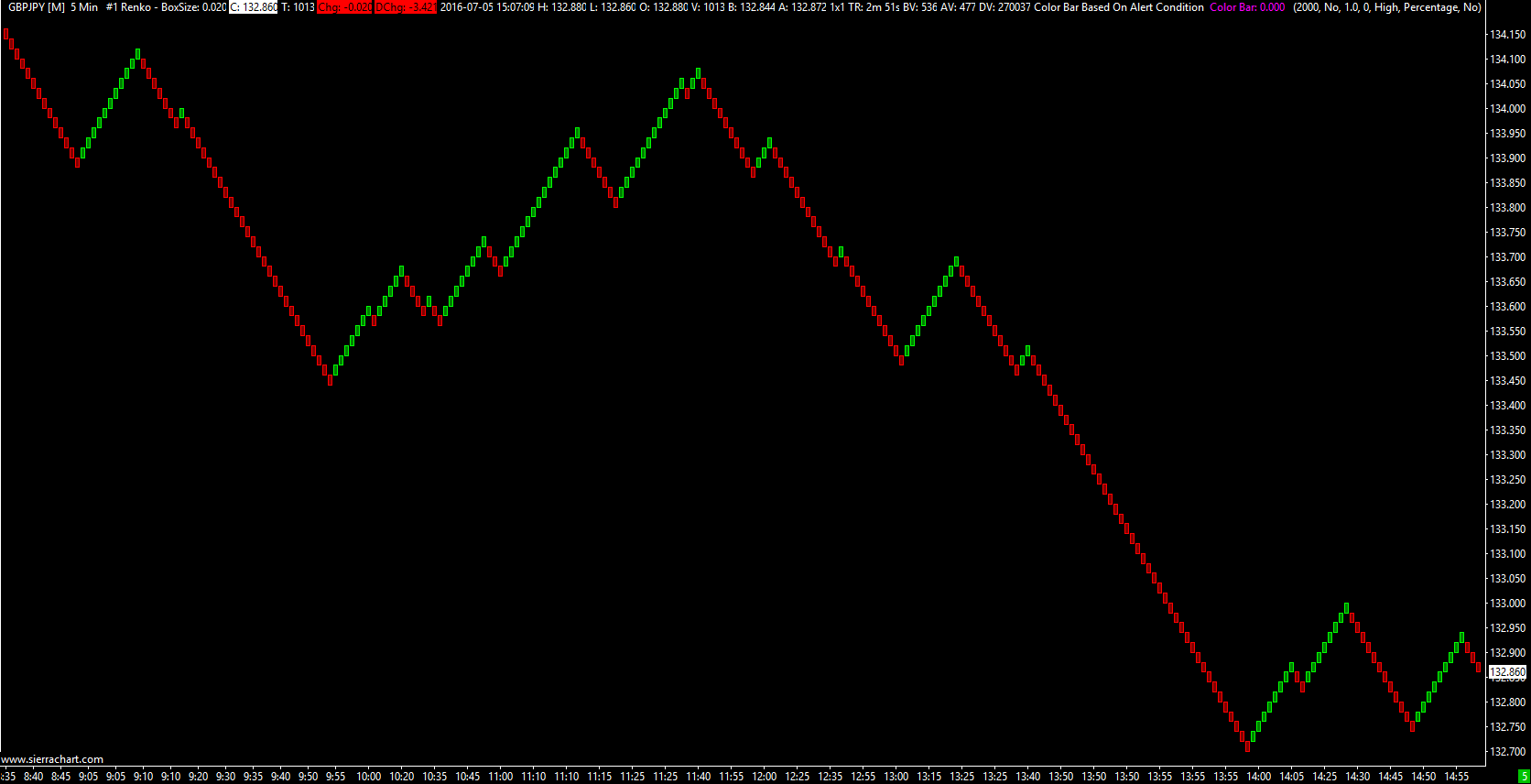

Yes. I am using Renko chart. http://www.sierrachart.com/image.php?Image=1467727631572.png |
| [2016-07-05 14:38:42] |
| Sawtooth - Posts: 4361 |
Try this: =OR(AND(ID3.SG1[-1]>ID3.SG4[-1],ID3.SG1<ID3.SG4),AND(ID3.SG1[-1]<ID3.SG4[-1],ID3.SG1>ID3.SG4)) where ID3 is the Renko Chart study. Edit as needed for your situation. The same documentation applies: http://www.sierrachart.com/index.php?page=doc/doc_StudyChartAlertsAndScanning.php |
| [2016-07-05 15:03:23] |
| User457299 - Posts: 38 |
Thanks a lot. I finally got it. Really appreciated that. Thanks again. |
