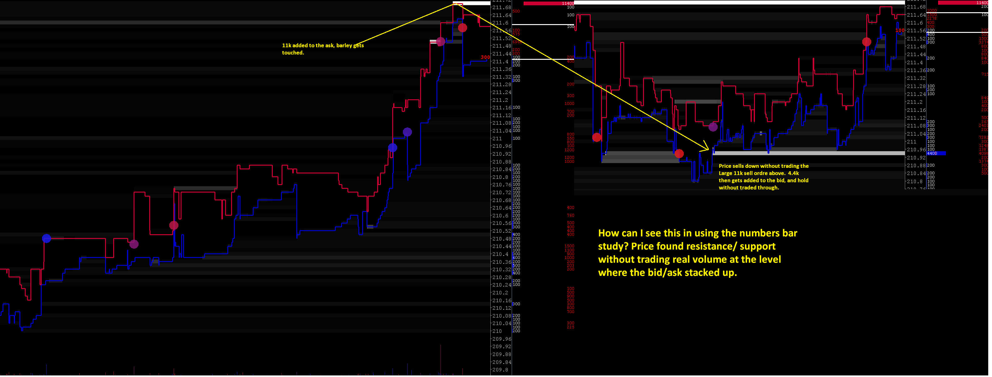

Why do I need to use the numbers bars study? Why can't the "market depth historical graph" show level 1 equities data? It's still effective at showing where large orders at the bid/ask have influenced the market.
Here is an example using a heat map with TSLA, using ONLY level 1 bid/ask data-
The heat map concept works just aswell, if not better in equities.

Actually, you are right. We mentioned using the Numbers Bar study because that would be the nearest match to the Market Depth Historical Graph study.
We see you are using IQ Feed. So market depth data will be maintained at level 1 for stocks.
So this should work at this time. Here is the relevant documentation:
https://www.sierrachart.com/index.php?page=doc/MarketDepthHistoricalGraph.php
