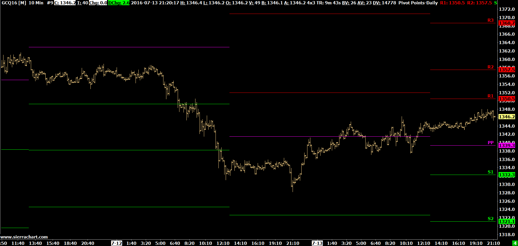

[2016-07-14 01:21:09]
This is what we see for GC (Gold) August using formula type 8:
http://www.sierrachart.com/image.php?Image=1468459224855.png
We do not see any problem.

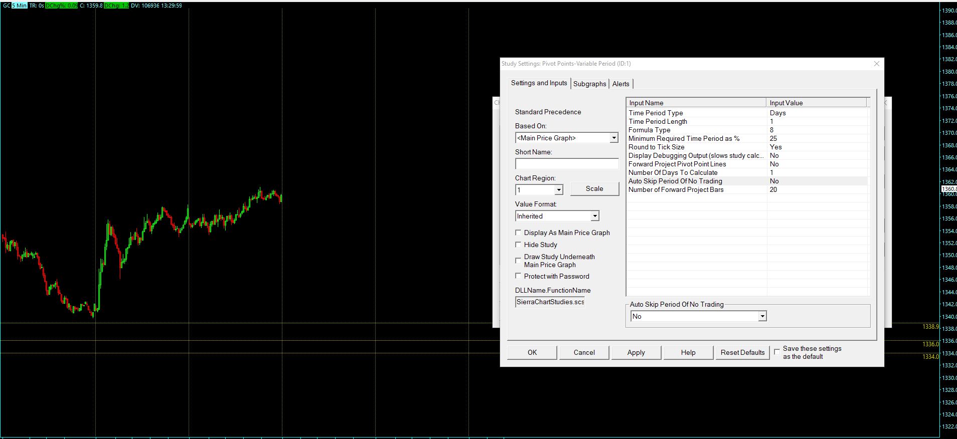

[2016-07-14 01:29:11]
User299392 - Posts: 216
See my file attached - same contract and not working with Pivot Points - Variable Period.
imageGold Pivots Not Working.JPG / V - Attached On 2016-07-14 01:28:42 UTC - Size: 328.85 KB - 462 views
[2016-07-14 02:20:54]
Set Auto Skip Period of No Trading to No.
The documentation does explain this.

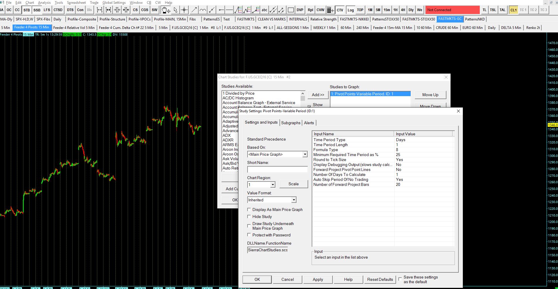

[2016-08-01 20:22:28]
This is again acting up.
Pivots will not calculate for GC futures product.
Image shows the settings of this study.
Please help!
imageGold Pivots Not Working 2.JPG / V - Attached On 2016-08-01 20:22:07 UTC - Size: 171.79 KB - 531 views
[2016-08-01 20:58:47]
Increase the Number of Days to Calculate input to see if they then appear.
Also would be better if you use the Pivot Points-Daily study instead.
