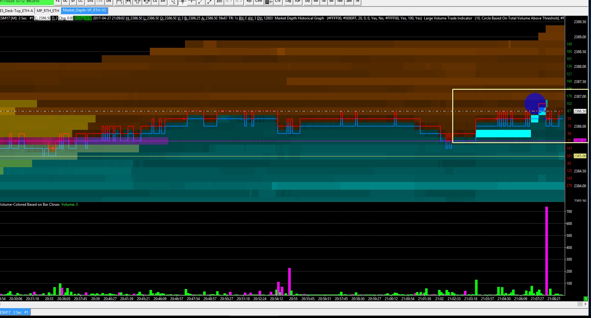

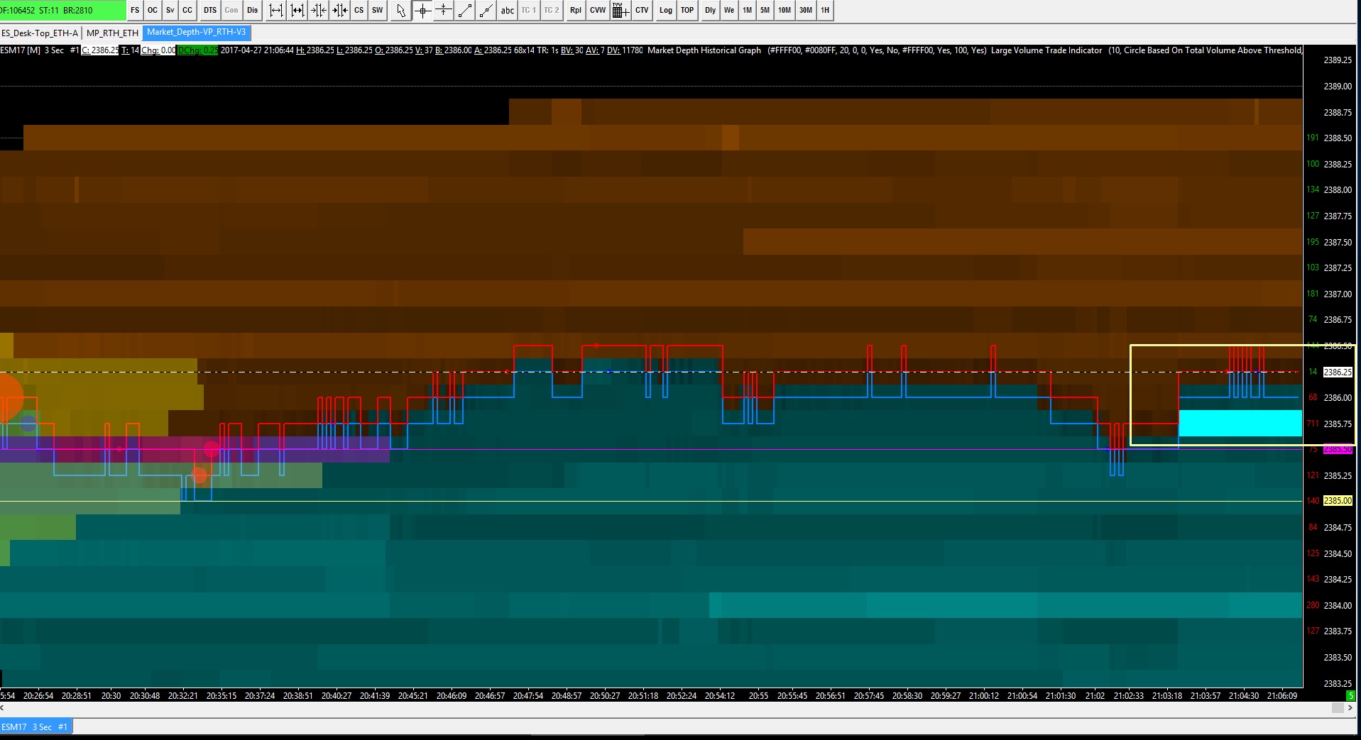

[2017-04-28 01:19:33]
User173602 - Posts: 16
SC Eng
I do hope you all can add an input to change the color along with the above max qty shading input.
Here's a good example of it that happened this evening during the JPY session. The 2nd screeny shows that the vol was legit and not a spoof, but none the less.
imageMDHG_042717-1.jpg / V - Attached On 2017-04-28 01:16:22 UTC - Size: 326.63 KB - 1540 views
imageMDHG_042717-2.jpg / V - Attached On 2017-04-28 01:16:28 UTC - Size: 431.83 KB - 1342 views

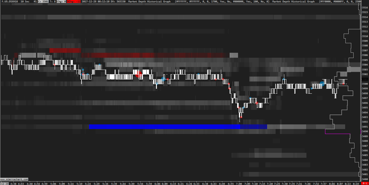

[2018-01-01 09:38:13]
ticinotrader - Posts: 431
Have you already tried to apply two sets of the Market Depth Historical Graph Study to the same chart?
On the screenshot below the white background colouring is based on 1700 threshold and the 'blue/red' is based on 2500. I set the second study to NOT extend the last known depth so this way the lower threshold depth study will be visible as well.
http://www.sierrachart.com/image.php?Image=1514799252971.png
[2018-01-01 14:33:47]

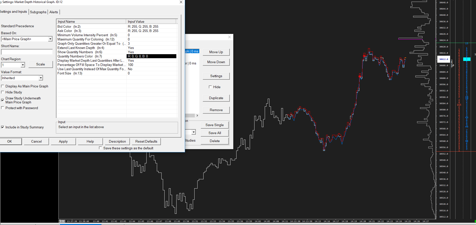

[2018-01-03 06:29:03]
User164231 - Posts: 281
Hi Ticino Trader,
What have I done wrong? The chart is not showing the orders like yours did (white to gray horizontal lines).
Date Time Of Last Edit: 2018-01-03 06:42:46
imageSetting up Heat Map.png / V - Attached On 2018-01-03 06:28:44 UTC - Size: 86.66 KB - 1403 views

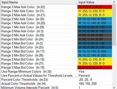

[2021-01-14 13:57:30]
AKR - Posts: 549
To USER NEO and User15952
Been desprately trying to find a useful setting for Market depth hist graph making it similar to bookmap.
I do like your black/white colors, wood be great if you could post your settings (complete ones) here.
Thx in advance !!!
[2021-01-15 13:58:11]
AKR - Posts: 549
solved. in case anyone interested, attached colors work awesomely....
imageBM Colors.png / V - Attached On 2021-01-15 13:57:52 UTC - Size: 45.2 KB - 937 views

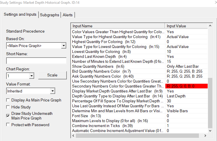

[2021-02-15 20:17:52]
Rino - Posts: 124
AKR
Thanks for posting the colors.
Would you mind showing what you have as settings below
Minimum Volume Intensity Percentage (In:5) 1
Thanks again
[2021-02-16 07:06:12]

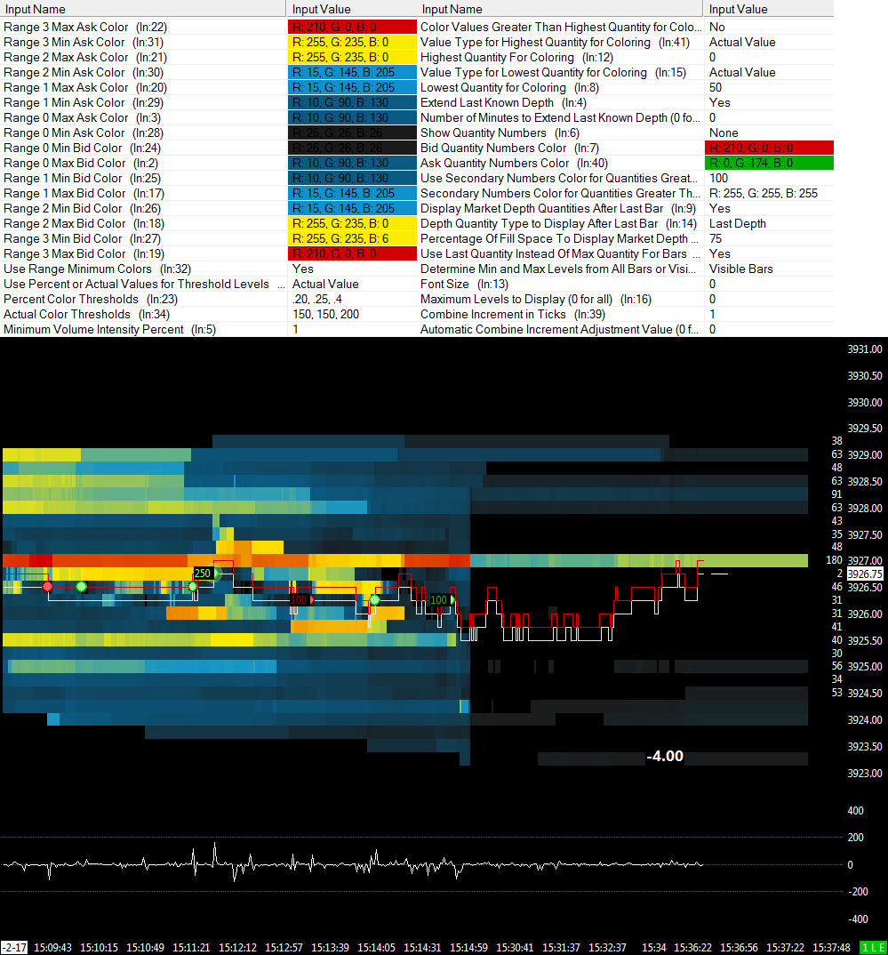

AKR - Posts: 549
sure. am using this setting for ES. For lighter markets I change the "lowest quantity for coloring" to zero.
imageScreenshot 2021-02-16 080429.png / V - Attached On 2021-02-16 07:05:56 UTC - Size: 59.64 KB - 704 views
[2021-02-17 21:47:46]
Rino - Posts: 124
AKR
Thank you.
I use Actual Value because it has consistent colors.
Percent as you know always changing.
I took screenshot after market closed. I use 50
as lowest Quantity so the dark areas more prevalent at this time.
I figured I would show you mine because you were kind enough to share.
