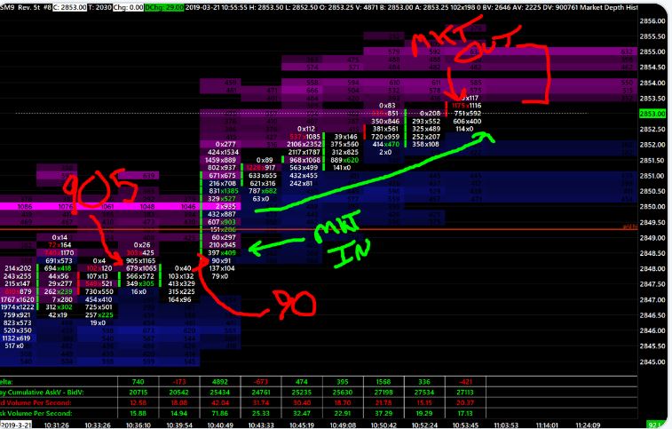

Woodenickel - Posts: 5
I'a new to Order Flow and struggling building a chartbook. The attached is what I'm looking for.
Thanks in advance.
You need to use the Numbers Bars study for this:
Numbers Bars
You will need to be using Sierra Chart service package 5 (Advanced). Follow the instructions below:
To change your Sierra Chart Service Package, select "Help >> Account Control Panel" on the Sierra Chart program menu. On the displayed webpage, click on the "Set Service Package for Renewal" link.
Or go to this page:
https://www.sierrachart.com/UserControlPanel.php?page=ServicesActivation
You will need to login if you are not currently logged in.
In the "Available Services >> Choose Usage Time Service Package" frame, select the Service Package that you want to set your account to. Press the "Set" button.
The remaining service usage time on your account will be adjusted based upon the cost of the package you are changing to. If the new package is a higher-priced package, then the usage time will be reduced due to the higher price.
There is no charge for changing your Sierra Chart service package. Only your Sierra Chart account usage time ending date is adjusted.

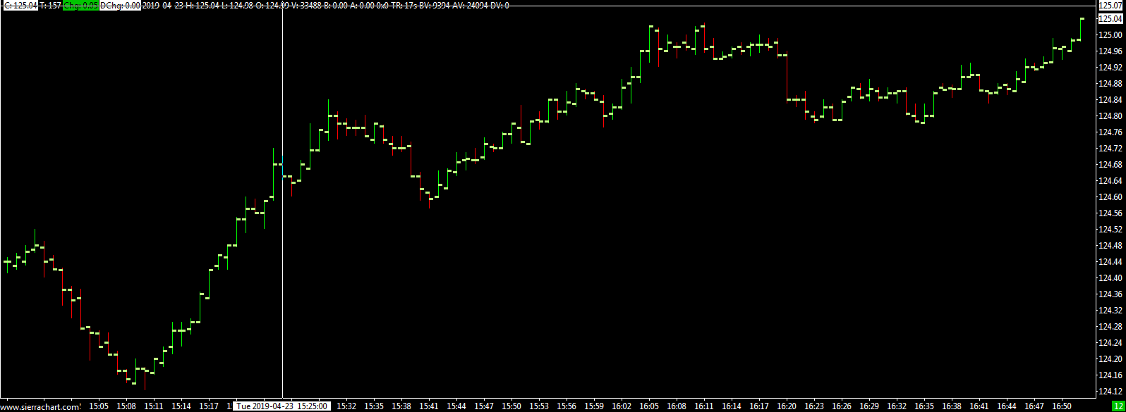

[2019-04-22 19:40:29]
Provide an image of the chart or Trade DOM, by following these instructions:
[2019-04-23 17:13:01]
User502561 - Posts: 36
http://www.sierrachart.com/image.php?Image=1556039449224.png
[2019-04-23 18:41:34]
What is wrong with that chart?
[2019-04-24 10:09:32]
is still on the same price
[2019-04-24 11:03:25]
What is the exact symbol of the chart? So the chart is not updating in real time?
