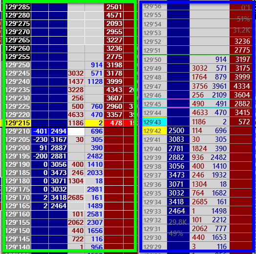

recently i figured out that there are different volumes on the dom for iqfeed and your data feed.. even though a tick here and there can be lost, but those differences baffle me. are you sure your data is correct? can you somehow back this? i am aware that this might well be an iqfeed issue but it would be very nice of you when you could double check that on your end and / or with barchart directly.
see attached screenshot, iqfeed in green and sc feed in blue.
thanks,
Andreas
image2016-05-19_11-49-57.png / V - Attached On 2016-05-19 15:54:53 UTC - Size: 98.87 KB - 449 views
[2016-05-19 17:30:53]
Do you notice a problem at the moment? We would not expect that you would. If this problem occurs at the time there has been some packet loss, that would explain it.
There can also be differences just simply due to subtle timing differences when those two Trade DOMs are updated. This is also a likely explanation.
Some packet loss which is usually very small, does occur and we have been persistent with about Barchart about this. We plan to follow up with them again and be more forceful. We are getting very tired of it assuming this is the reason for the problem.
Otherwise we do know the data is 100 percent correct as long as there is no packet loss. There was some packet loss for today during the 9 AM hour. For CBOT it was 0.002%. So you can see it is very small.
So this means that there could have been a few momentary instances of this. But you should not notice any difference during any other hour today. At any other time today we are certain the data is 100 percent complete.

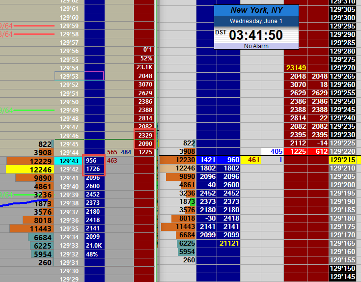

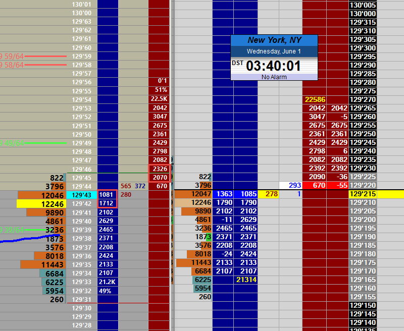

[2016-06-01 07:43:29]
Cavalry3162 - Posts: 523
made 2 new screenshots with time.. the offset seems "fix" as its the same amount between those 2 screenshots.
image2016-06-01_03-40-10.png / V - Attached On 2016-06-01 07:43:22 UTC - Size: 100.14 KB - 403 views
image2016-06-01_03-42-00.png / V - Attached On 2016-06-01 07:43:26 UTC - Size: 92.45 KB - 444 views

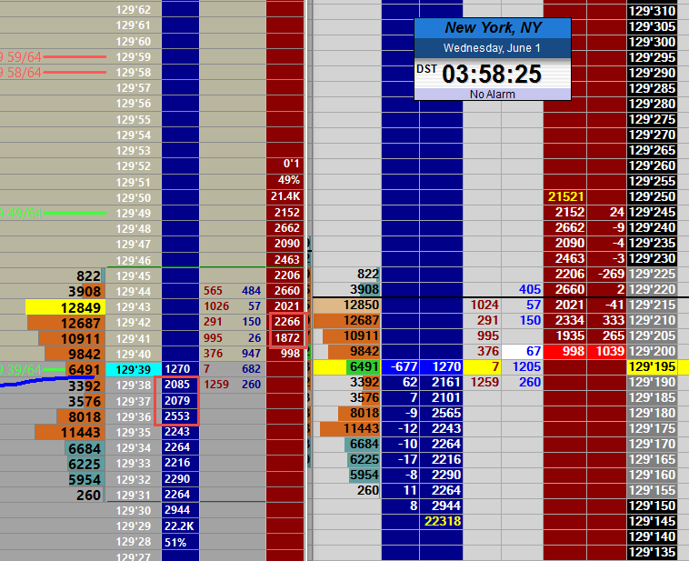

[2016-06-01 07:59:46]
and another one to make sure it persists even after your 15min reset
image2016-06-01_03-58-40.png / V - Attached On 2016-06-01 07:59:42 UTC - Size: 104.95 KB - 453 views
[2016-06-01 08:11:29]
There is zero percent packet loss at this time, so that is not the cause of it. Knowing how the market depth data is processed and transmitted we are 100% confident the data is accurate.
Even in the case when the most recent snapshot every 15 minutes from the CME is received and transmitted, even that is not a problem because that is up-to-date data direct from the CME and we would not expect it to be older than any more then maybe milliseconds.
The other data feed you are comparing to does not look to have 100 percent up-to-date data at those levels.
Also we are comparing to IQ Feed at the moment for the ES June 2016 futures. We do not see any differences. They are an identical match after monitoring for a couple of minutes. When the values are updating frequently, they can be different for short moments in time, but once a quantity settles for a second or two, we see a match.
[2016-06-01 08:13:26]
In response to post #11 we are confident the data you are seeing from the Sierra Chart Exchange Data Feed is accurate.
With everything we know we have no reason to think otherwise.

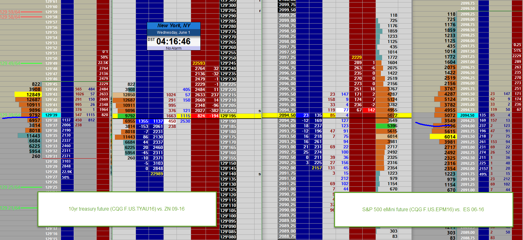

[2016-06-01 08:23:21]
Hello Support,
the "other feed" is iqfeed..
however, thank you for checking this! I verified that the ES is 100% identical, its the treasuries which dont be the same. (made another screenshot).
so, i guess its an iqfeed issue then even though its strange that its always higher numbers on iqfeed. i understand that there are some pulls but if its always a higher number its odd..
Andreas
image2016-06-01_04-17-01.png / V - Attached On 2016-06-01 08:23:16 UTC - Size: 256.89 KB - 374 views
[2016-06-02 06:16:58]
We have looked into this, and we are 100 percent certain the data you are getting from the Sierra Chart Exchange Data Feed is correct and is exactly what the CME is providing.
The way that the market depth data is processed for the ES is identical to all other symbols. So if it is correct for that symbol, it is correct for other symbols.
Perhaps it is possible, although we have never had any clear indication of this, that the periodic refresh of the depth data from the snapshot data every 15 minutes could under some conditions possibly cause a momentary issue with the market depth data. After looking over the screenshots you provided, we do not think this applies here.
It is also possible with the way the CME transmits market depth updates on the incremental feed, there may not be any possible issue to begin with. That is probably what we would expect.
Date Time Of Last Edit: 2016-06-02 06:18:01
