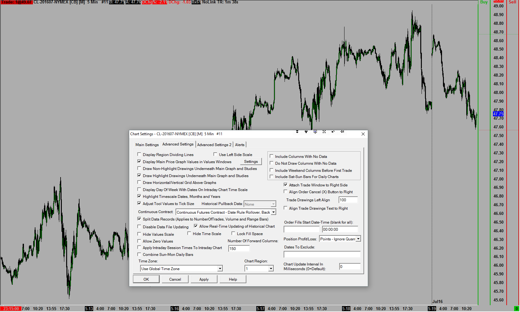

I am using Date-rule rollover, Back-adjusted, and there is a 56 tick gap today with the rollover. It is the same gap if I choose a simple Date-rule rollover.

Yes, of course I re-downloaded the data before opening a thread. Please see attached picture.

[2016-05-19 17:25:11]
Did you follow the documented procedure? In our experience often users do not follow the exact documented procedure. If the data is re-downloaded and the Symbol Settings are correct, there is no reason why you would have this problem.

[2016-05-19 19:21:20]
phaedonk - Posts: 352
I deleted the files manually and this worked. All other solutions did not work. Thank you.
