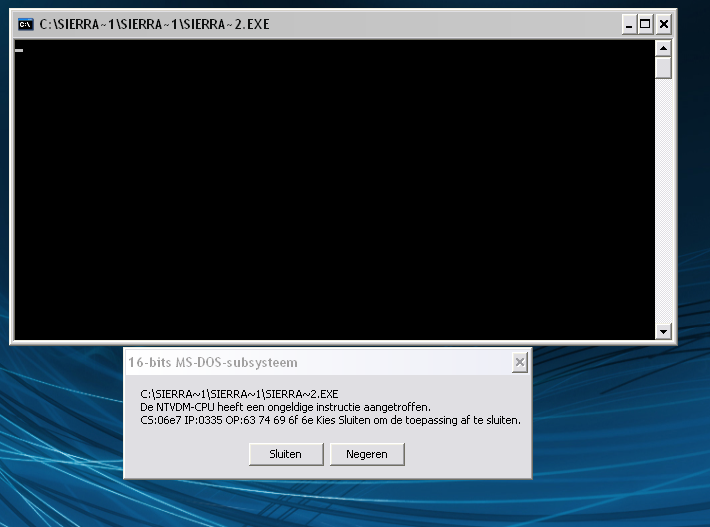

After trying to update nothing changes. I am still working with 990. On my XP machine I am getting a messing you can see in the attachment. On my W7 machine nothing happens at all. SierraCharts is closed when I try to update. Nothing changes.

I fixed the problem on my W7 machine, unfortunately I didn't on my XP machine. The system told me, look at the attachment, there is something with a 16 Bit MS-DOS subsystem? What's this??? I tried everything, also uninstalling of everything and deleting also all references in the registry, no success at all.

Hello, I did almost everything trying to resolve the problem but not succeeded...... Deinstall and re-install all frame network versions on my XP computer. Still the message in this topic as you can see in the attachment. Of course I tried also the suggestions you told me to do. There is now also version 996. I now have also problems to update again on my W7 computer.... In the past I never had these problems. You changed something I read somewhere, maybe this could be the problem? On my Windows XP machine I can't install net framework 4.5, this is not supported. I am getting very frustrated, is there anybody who can help me please?
