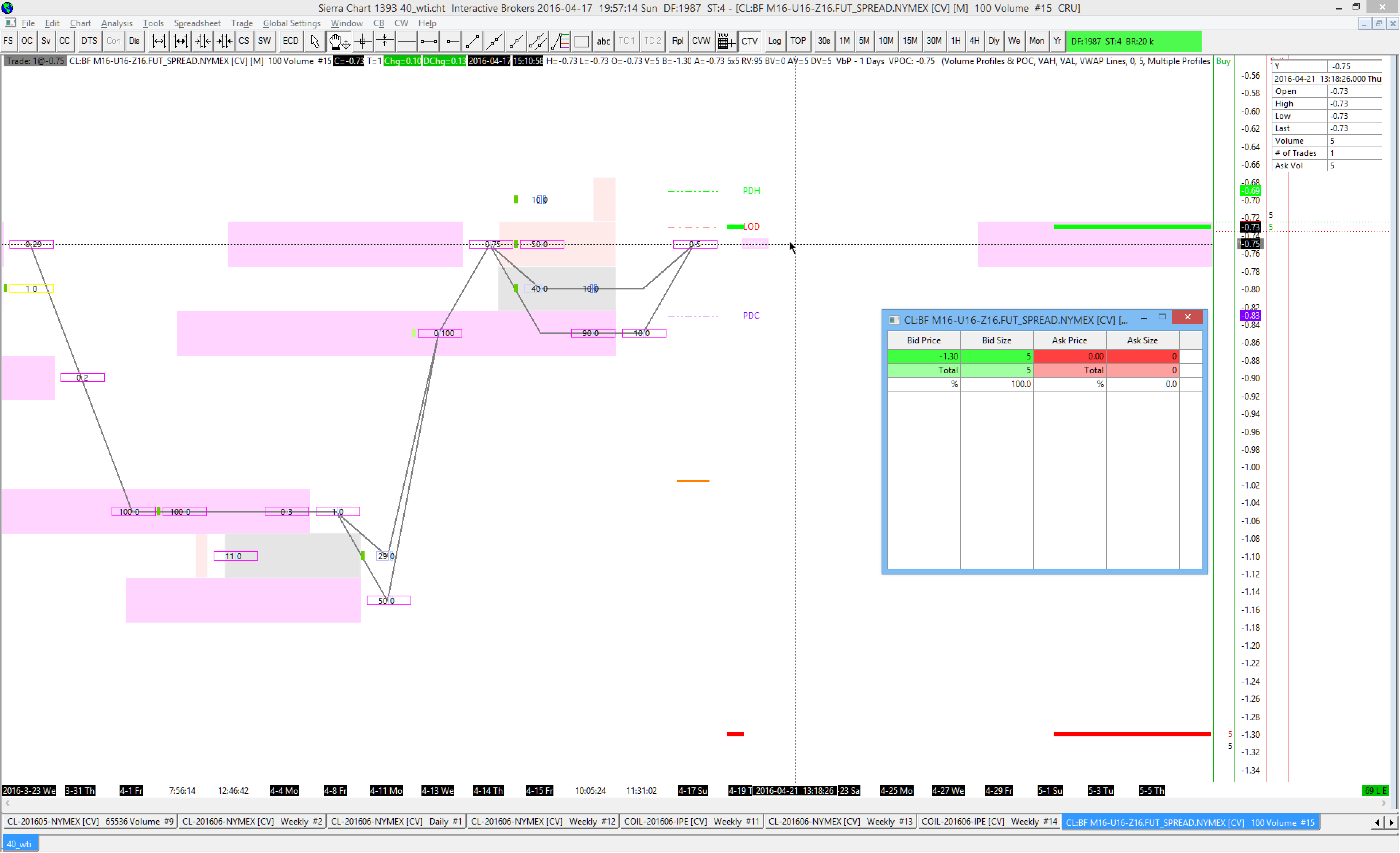

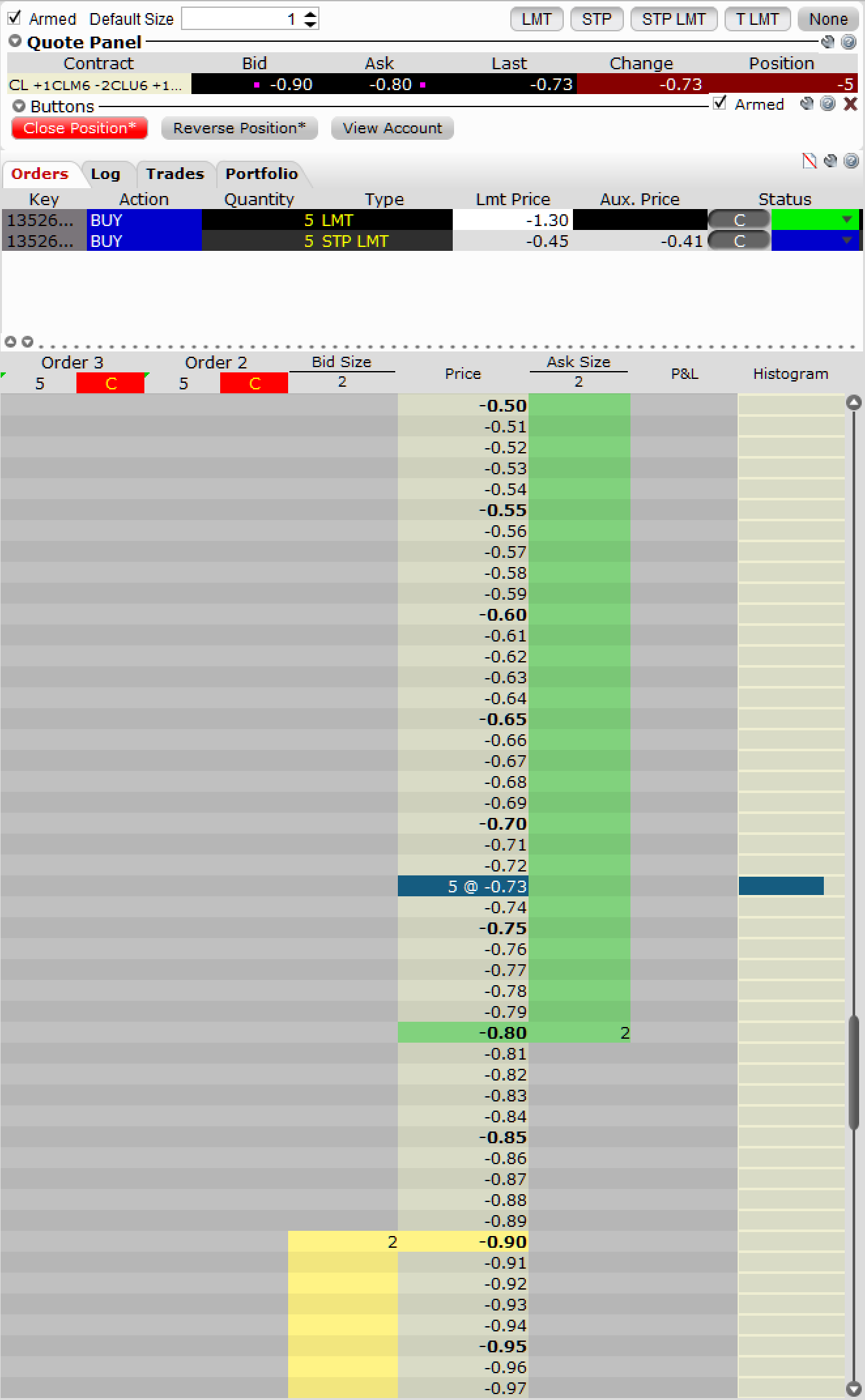

Attaching a chart here incorrectly showing the last trade at -0.75 (it wasn't, it was -0.73 - because it was my actual trade). Additionally, the DOM seems to be reflecting stale quotes as the current ask (being flashed on and off) is -0.80, not -0.73 (which was my offer before it got filled) and a best bid of -0.87. A non-number bars study shows the trade at -0.73, the problem here is with number bars (and the stale quotes in the DOM). The fact that I'm seeing totally old data on the DOM makes me wonder how live this data even is.
Also, the tick data only goes back to 3/23, meaning less than 3 weeks of actual data - but I know these spreads within SC have been available for quite a few months now. Where's the older data? There's prints on this spread all the way back to October of 2014, so it's not an issue of it not trading then. I don't expect SC to have data all the way back then, but I do expect it to have data older than 3 weeks.
imagesc_ets_problems.png / V - Attached On 2016-04-18 00:51:57 UTC - Size: 67.56 KB - 435 views

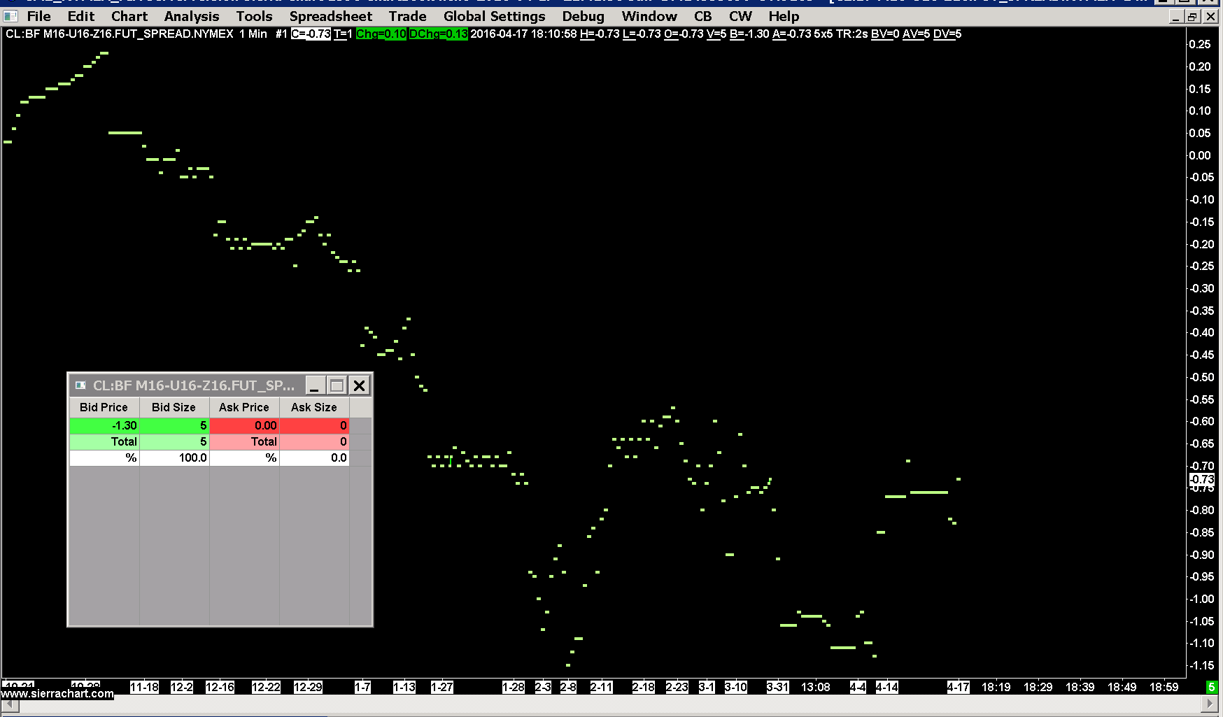

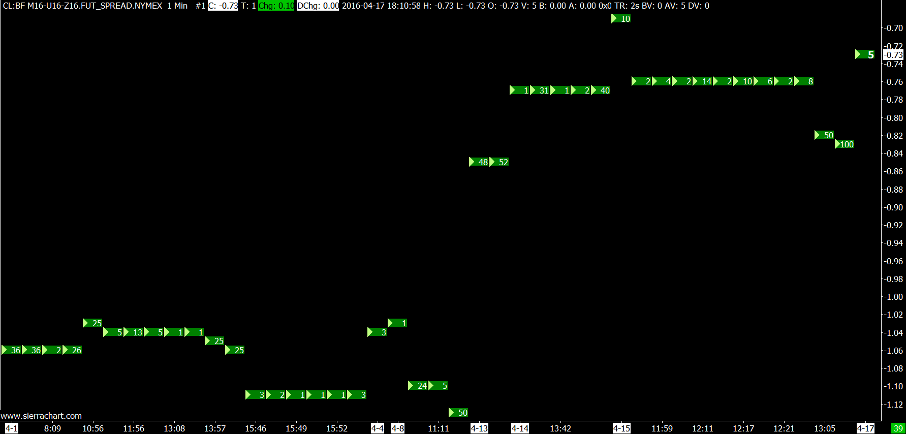

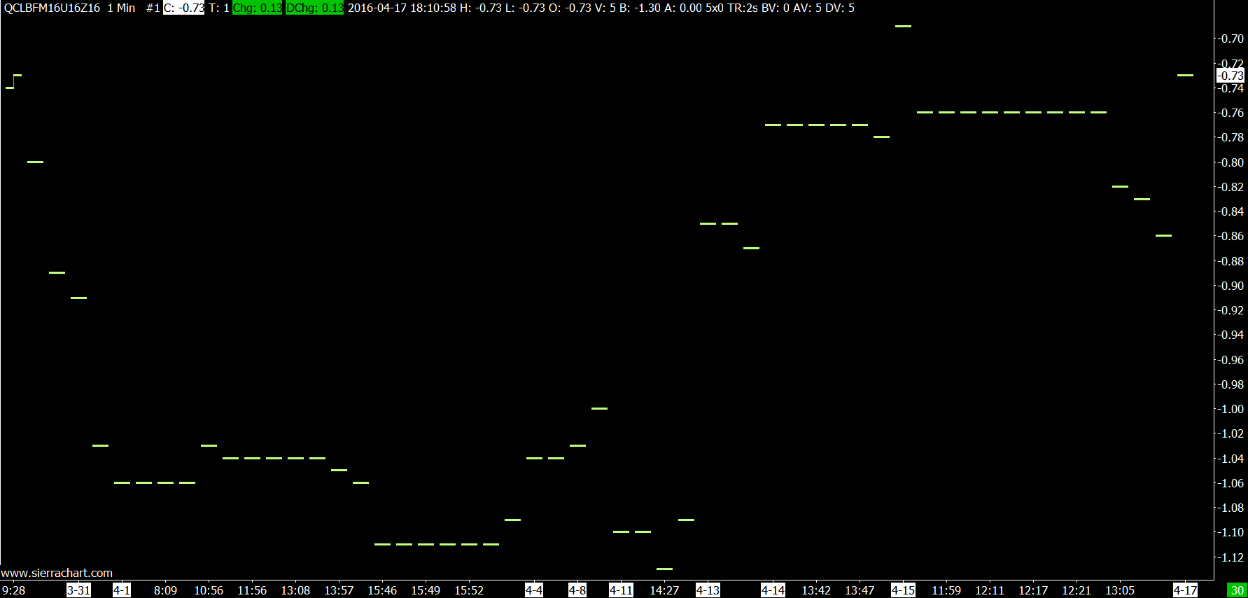

There's basically 3 issues, 2 of which are more important:
1. Numbers bars shows -0.75 but normal chart shows -0.73.
2. Market depth is all wrong (this *might* have to do with implied vs outright prices).
3. The past data issue - which was solved by deleting and redownloading the data (however, this seems like I shouldn't have to do that, but let's forget about it for now).
imagesc_ets_problems1.png / V - Attached On 2016-04-18 03:03:46 UTC - Size: 295.54 KB - 375 views
imagesc_ets_problems2.png / V - Attached On 2016-04-18 03:03:56 UTC - Size: 142.89 KB - 385 views

Keep watching the bid/ask. This particular spread has bids and asks that come and go, so it's entirely possible you saw -1.30 and no ask some time ago. You're specifically seeing -1.30 because it's my actual order out there (really, the other bids come and go leaving a huge apparent spread). For instance, I've just changed my resting limit to -1.31 and you should see that - however, you should also see much closer bids and asks than that - it's only when the inside market disappears that you'll see the extremes of no ask and my limit order on the bid.

1. Here is a Numbers Bars chart of that symbol:
http://www.sierrachart.com/image.php?Image=1461189623988.png
We are not seeing a problem with the last trade on that day showing on the Numbers Bars. We would not expect a problem.

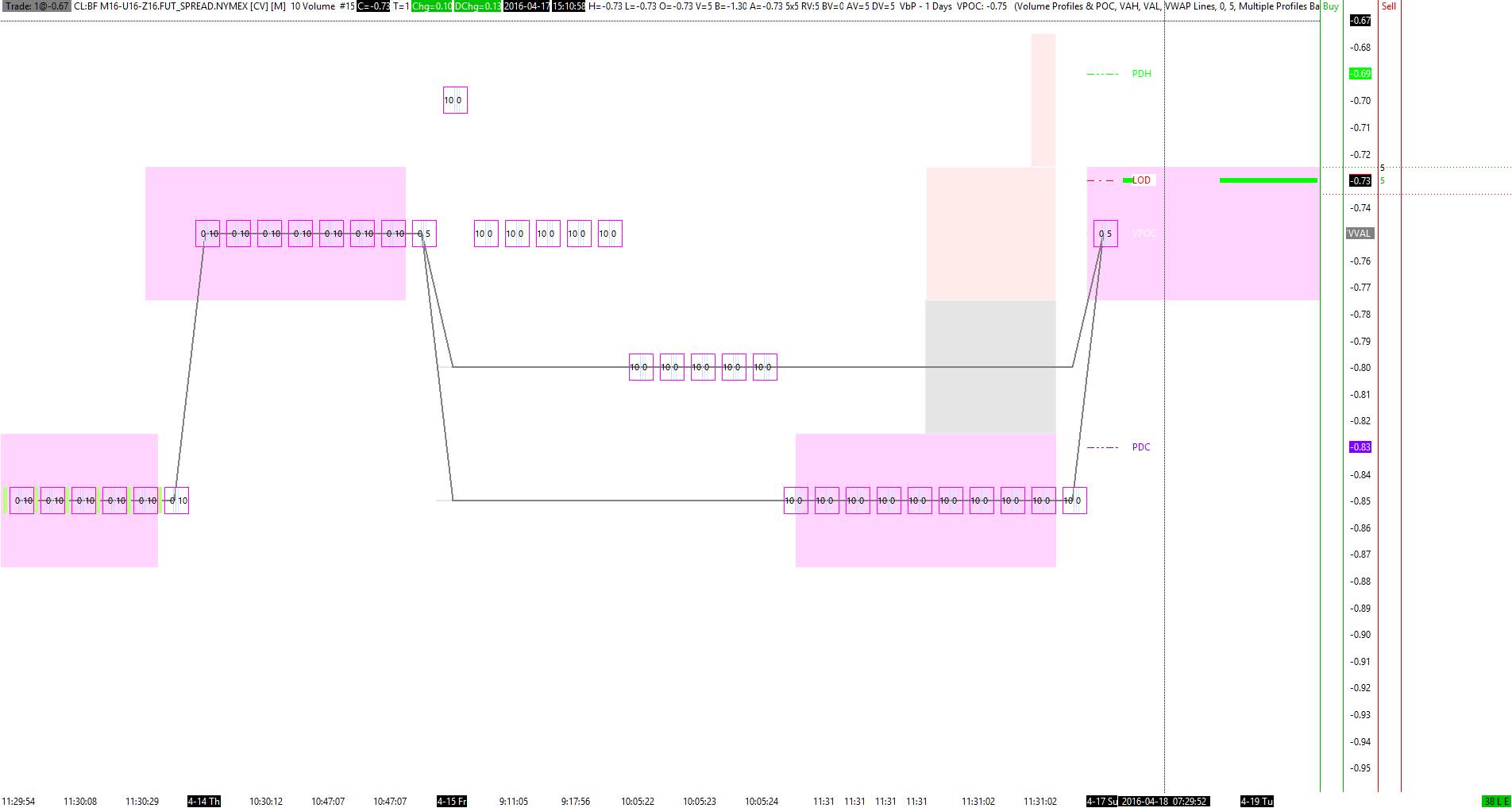

i960 - Posts: 360
No, the problem is still there, so consider it's something else other than a "temporary" problem.
Look, the problem here is "volume at price mult", a setting I never even set, being set to 5.
And that setting is obviously being driven by the volume by price and/or numbers bars study which is forcing it to 5 when changing charts from intraday to daily. This is also super easy to reproduce: have a VBP with 5 ticks per bar (which is completely normal), have the intraday chart set to 1 for "volume at price mult", change the period to daily, now watch all the prices instantly be wrong because the chart just changed your "volume at price mult" to 5 without your input. This in itself isn't a big issue because it's a daily chart and numbers bars accuracy isn't even useful there. However, change it back to intraday and watch said "volume at price mult" of 5 still be used and prices still be wrong. The best part is someone even reported this bug in the past and it was shunned as "user error": volume profile ticks and chart period
Here, let me make it easy: When changing from intraday to daily, the chart changes "volume at price mult" to 5, which is documented in the documentation as "saving memory". Go to chart settings and change it back to intraday and watch the same "volume at price mult" of 5 still be used. That is a straight up bug, the same one reported a year ago.

This is no longer the case:
If it is, it is only because it was 5 on an Intraday chart previously. Anyone else testing what you describe on a new chart will not experience that. We could not even get the Volume at Price multiplier to change to 5 either when going to a Daily chart. We have to look into that because we would expect that.
