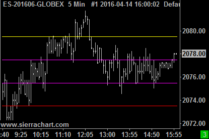

I am attempting to create an ACD indicator, and to create the “A” up and “A” down (which are horiz. lines above and below the opening range), it seems the High/Low for a Time Period – Extended study is ideal to begin the process. On an intraday chart, I am able to add a horiz. line above the high using Study Subgraph Add and set “Add to zero values in Based on Study” to “no”, but cannot do the same to create the lower line using Study Subgraph Subtract as there is no option (for add to zero values). The “add” issue was mentioned and fixed here: Trouble using Study Subgraph Add for extending High/Low For Time Period
1) So I was wondering if the same option could be added to Study Subgraph Subtract so the lower horiz. line doesn’t go to zero between sessions.
2)On an intraday chart, is it possible to add/subtract a percentage of the daily ATR to the top/bottom of the opening range using Study Subgraph Add/Subtract?
The pink lines are the H/L of the first 5 minutes and the yellow/red lines are a fixed # of pts. above/below. So I would like to make the level of the yellow/red lines a % of daily ATR added/subtracted to the pink lines.

Disregard point 1) above. I was able to use a negative number for a second instance of Study Subgraph Add - Extended and add that to the low of the opening range.

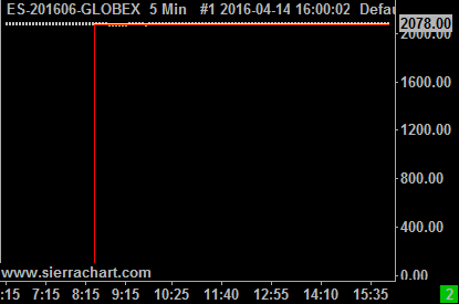

I ported daily ATR to an intraday ES chart, and then used Study Multiply to obtain a fraction of the ATR. Then used Study Subgraphs Add and SS Difference to add and subtract from the opening range lines. BUT, the lines go to zero after midnight. Can you all add an option for "add to zero values" for the Subgraphs Add and Difference? I have looked at the Initial Balance study but it only draws a line 1 bar wide.
It is not clear what you are looking for. Did you want Study Subgraphs Add and Difference studies to not perform the arithmetic at a chart column where one of the Subgraph values is 0?

I would like Study Subgraphs Add and Difference studies to not perform arithmetic (and thus not draw a line on the chart) if one of the Input Studies is 0. In this case, one of the inputs for both studies is High/Low for a Time Period - Extended, which has a 0 value after the end of the session.
[2016-04-16 09:48:01]
The input for these will be added in the next release.
