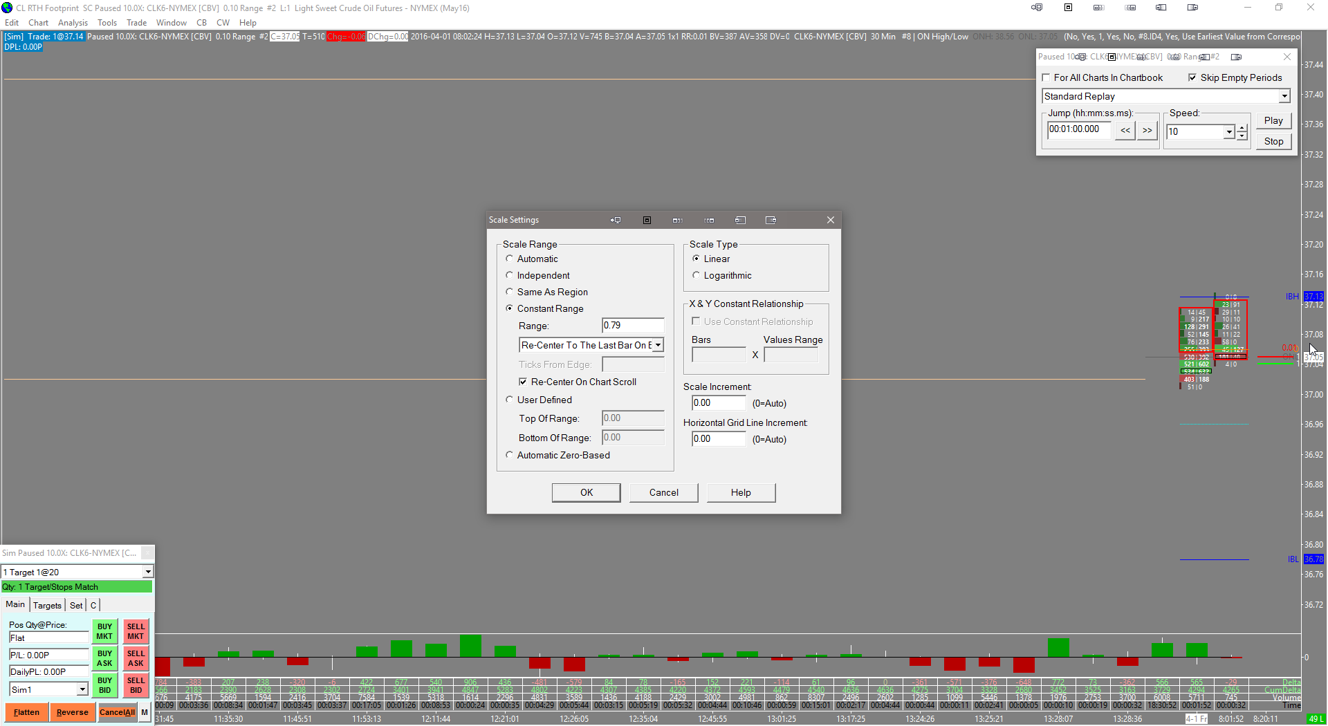

numbers bar study chart not changing to price open when gapping out of view

i have noted in this thread/post in #2 what is going on. it seems that its just with the numbers bar study applied because i dont seem to have the issue on a volume bar chart: numbers bars POC not filling cell | Post: 86178
im not sure if this is a scaling issue or an issue with the numbers bar but if there is a gap in the chart and we open out of the view of the window from the previous close the chart wont go to the new opening price on the open print but it will focus to price when the second bar on the chart is printed. i have shown my scaling settings in case you need that info to test.

The constant range mode that you are using (Re-Center To The Last Bar On Every Update) will center to the combined average prices of the last two visible bars. If the price difference between the last two visible bars is greater than the price range of the chart, then both bars may appear off the top and bottom edges of the chart. You may want to try a different constant range mode for your chart scale settings if this is a common occurrence.
