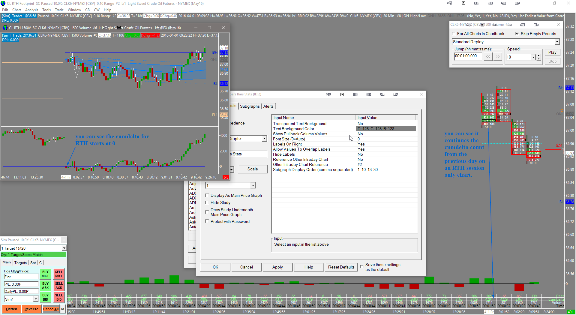

i have found a couple other issues with numbers bars and numbers bars stats studies.
1. if i have these indicators applied on an RTH session chart with the numbers bar stats showing cumdelta it carries over the cumdelta total from the previous day instead of starting at 0. well i was flipping between sim and live and it somehow corrected itself. i showed a screenshot of the issue happening in chart replay.

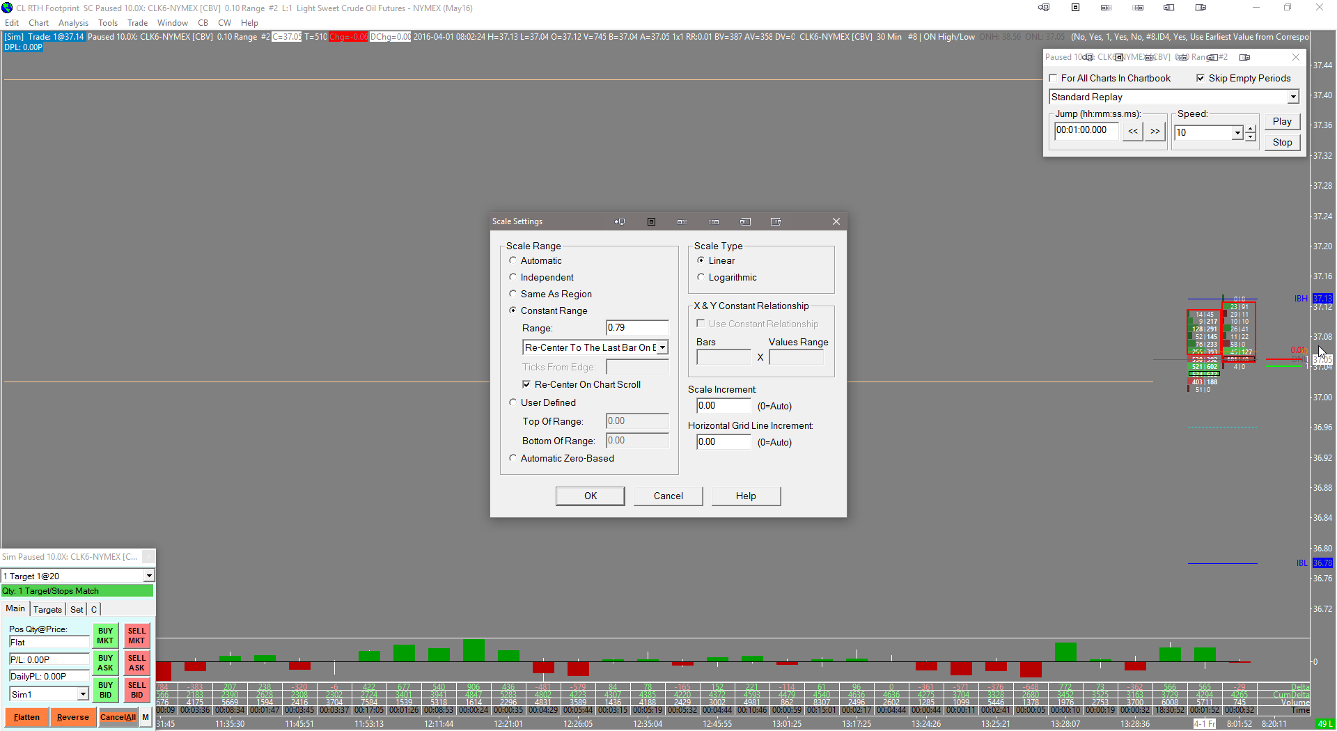

2. im not sure if this is a scaling issue or an issue with the numbers bar but if there is a gap in the chart and we open out of the view of the window from the previous close the chart wont go to the new opening price on the open print but it will focus to price when the second bar on the chart is printed. i have shown my scaling settings in case you need that info to test.
