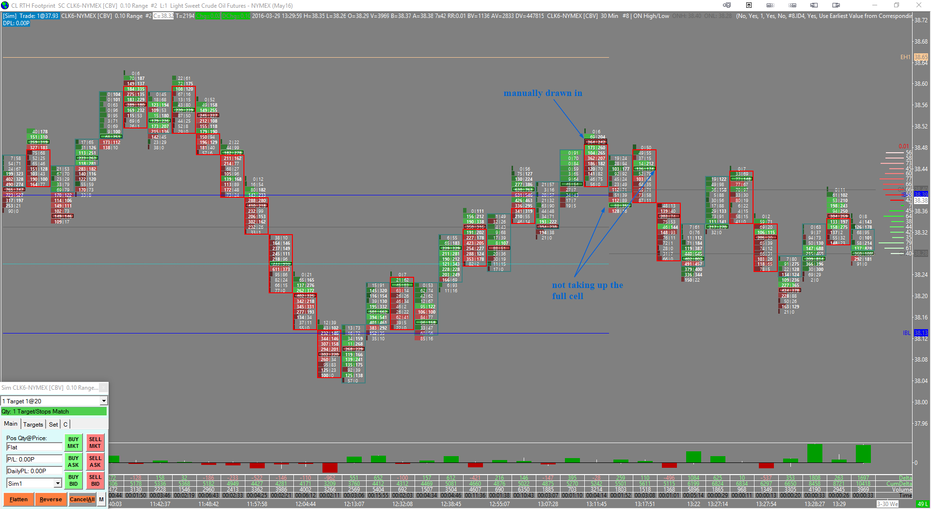

is it possible to adjust the way the POC shows on the numbers bars so they fill to the outside of the cell instead of just around the numbers? nice update today with the numbers bars candle fill/outline, much appreciated! screenshot below:
imageSierraChart_2016-03-29_13-46-37.png / V - Attached On 2016-03-29 18:55:36 UTC - Size: 169.93 KB - 482 views
[2016-03-29 19:25:13]
We have to look into this. This does not look right.
[2016-03-29 22:19:39]
Al SC Developer - Posts: 434
This is being adjusted in the next version.

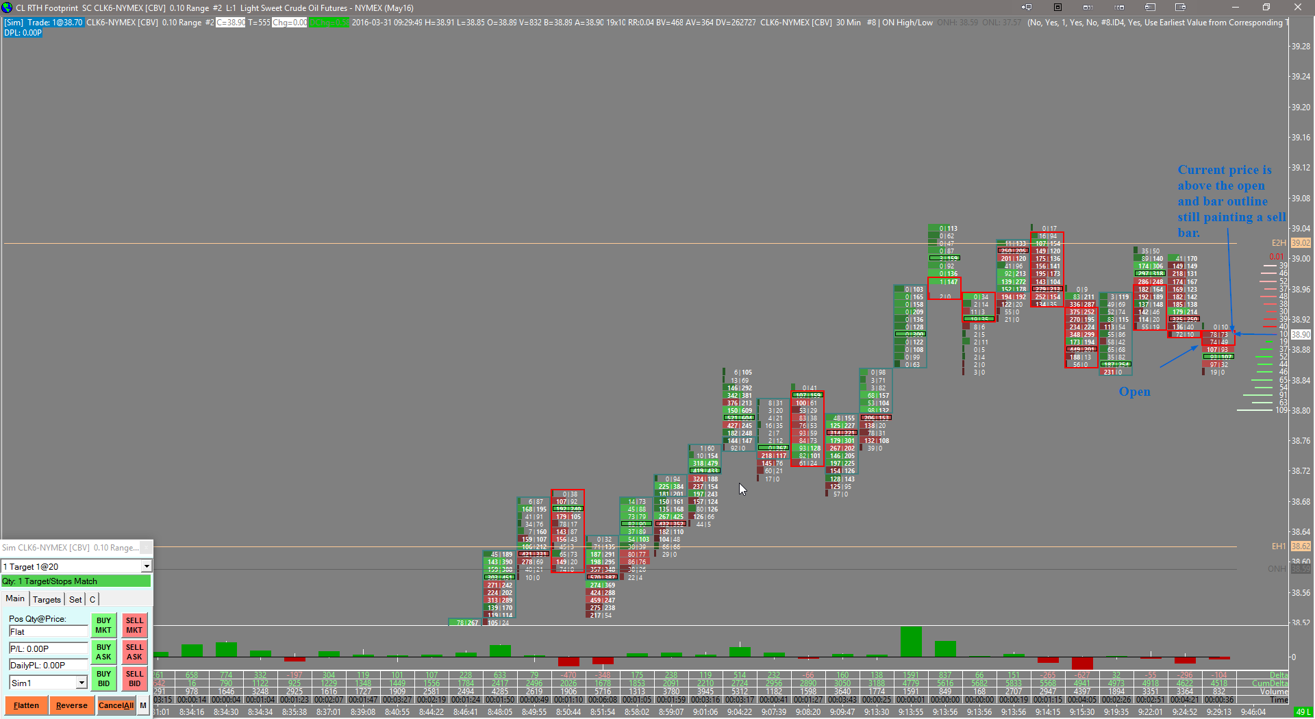

this might be another issue with how the candle outlines are showing negative or positive coloring in the developing bar.
imageSierraChart_2016-03-31_09-29-53.png / V - Attached On 2016-03-31 14:34:27 UTC - Size: 133.06 KB - 472 views
[2016-03-31 14:43:49]
Yes, this will be addressed in next version.

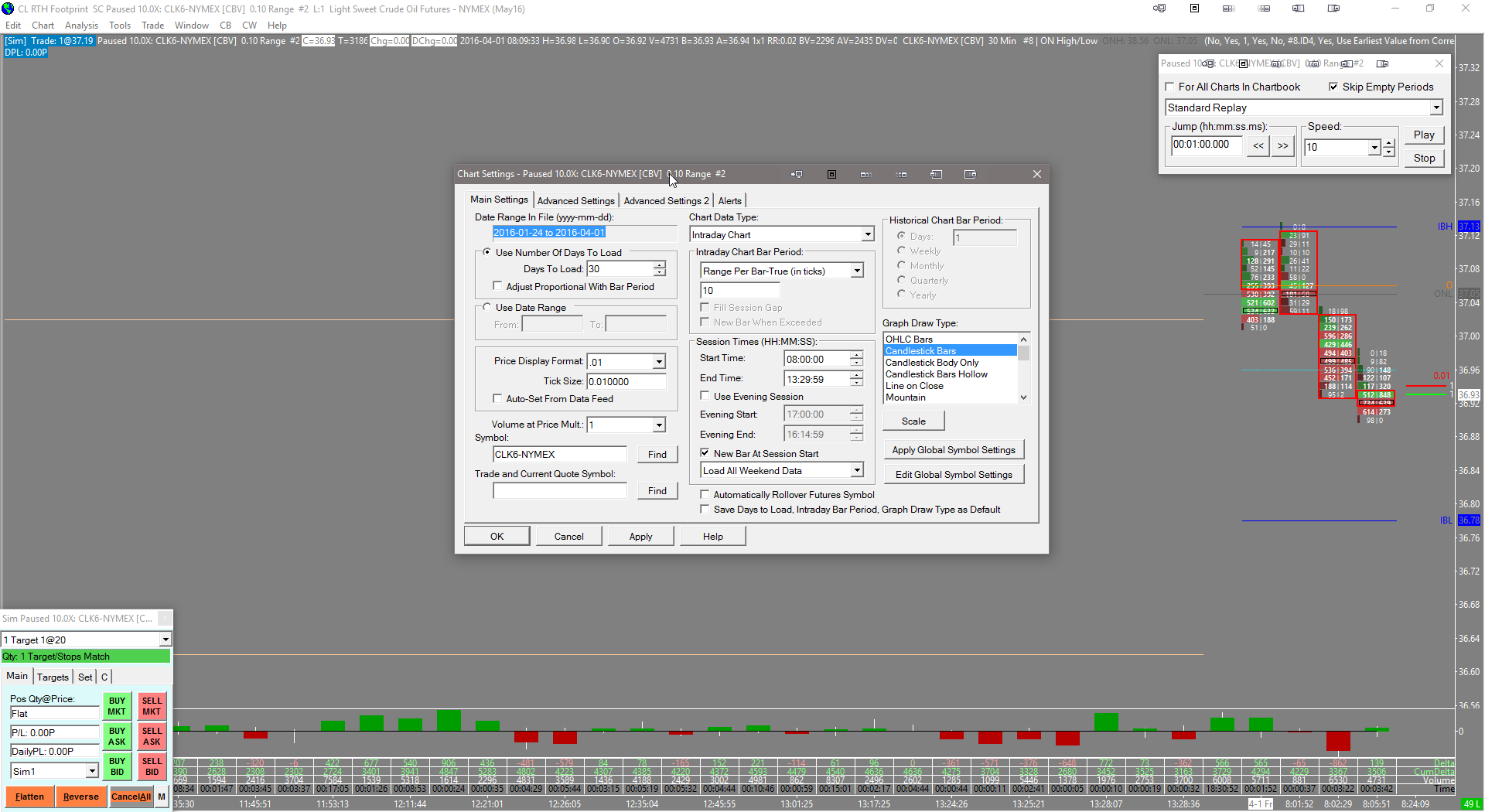

i have found a couple other issues with numbers bars and numbers bars stats studies.
1. if i have these indicators applied on an RTH session chart with the numbers bar stats showing cumdelta it carries over the cumdelta total from the previous day instead of starting at 0. well i was flipping between sim and live and it somehow corrected itself. i showed a screenshot of the issue happening in chart replay.
2. im not sure if this is a scaling issue or an issue with the numbers bar but if there is a gap in the chart and we open out of the view of the window from the previous close the chart wont go to the new opening price on the open print but it will focus to price when the second bar on the chart is printed. i have shown my scaling settings in case you need that info to test.
imageSierraChart_2016-04-01_10-48-45.png / V - Attached On 2016-04-01 16:05:35 UTC - Size: 168.02 KB - 485 views
imageSierraChart_2016-04-01_10-52-36.png / V - Attached On 2016-04-01 16:05:39 UTC - Size: 135.63 KB - 427 views
imageSierraChart_2016-04-01_10-53-51.png / V - Attached On 2016-04-01 16:05:44 UTC - Size: 105.56 KB - 422 views
[2016-04-01 19:18:34]
1. This is now fixed. It will be out in the next release.
2. For this, select Chart >> Reset Scales and see if you notice it again. If you do, start a new support request.
