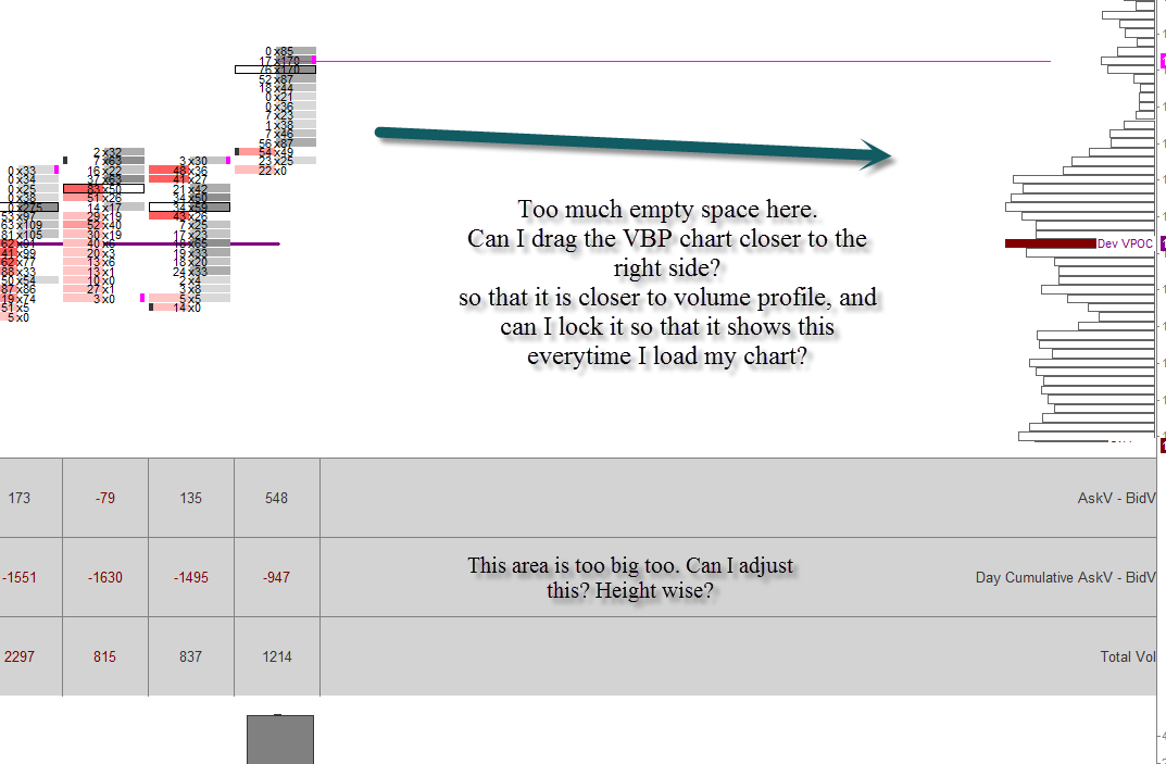

[2013-07-26 15:43:34]
andrewijaya - Posts: 6
Hello Max,
I have a question. I am currently using Vol by Price study, and it is quite unfortunate that there are many blank space wasted between the chart and the volume on the right most side.
Can you please help me how do I set this up so that I can drag the VBP chart closer to the right edge of the chart, as well as locking it so that it will default like that?
[2013-07-26 15:57:32]
First please follow the instructions here:
http://www.sierrachart.com/index.php?l=doc/doc_VolumeByPrice.html#RightAligning
If you still need help, we need to see an image of what you already have. Please post an image of the chart, following these steps:
https://www.sierrachart.com/index.php?l=PostingInformation.php#Image
[2013-07-30 13:12:32]
Yes I still need help with my question above.
image7-26-2013 11-30-28 AM.png / V - Attached On 2013-07-30 13:12:05 UTC - Size: 103.86 KB - 776 views
[2013-07-30 17:06:26]
1. You need to reduce the fill space on the right side of the chart. To do this you just need to unlock it and click on the left arrow on the scroll bar at the bottom of the chart. This is documented here:
https://www.sierrachart.com/index.php?l=doc/doc_WorkingWithCharts.html#ScrollingTheChart
2. To reduce the height of the table at the bottom, refer to this section about adjusting the height of chart regions:
https://www.sierrachart.com/index.php?l=doc/doc_WorkingWithCharts.html#ChartWindowandRegions
