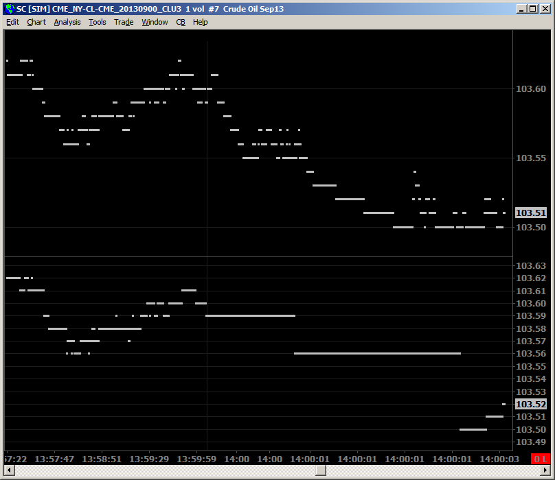

TastyRisk - Posts: 119
So can an accurate chart overlay be obtained with this new code ?
Example picture from v951 overlaying main chart data into region#2.
Date Time Of Last Edit: 2013-07-30 21:03:35
imageMILI.png / V - Attached On 2013-07-30 20:58:38 UTC - Size: 18.77 KB - 859 views
