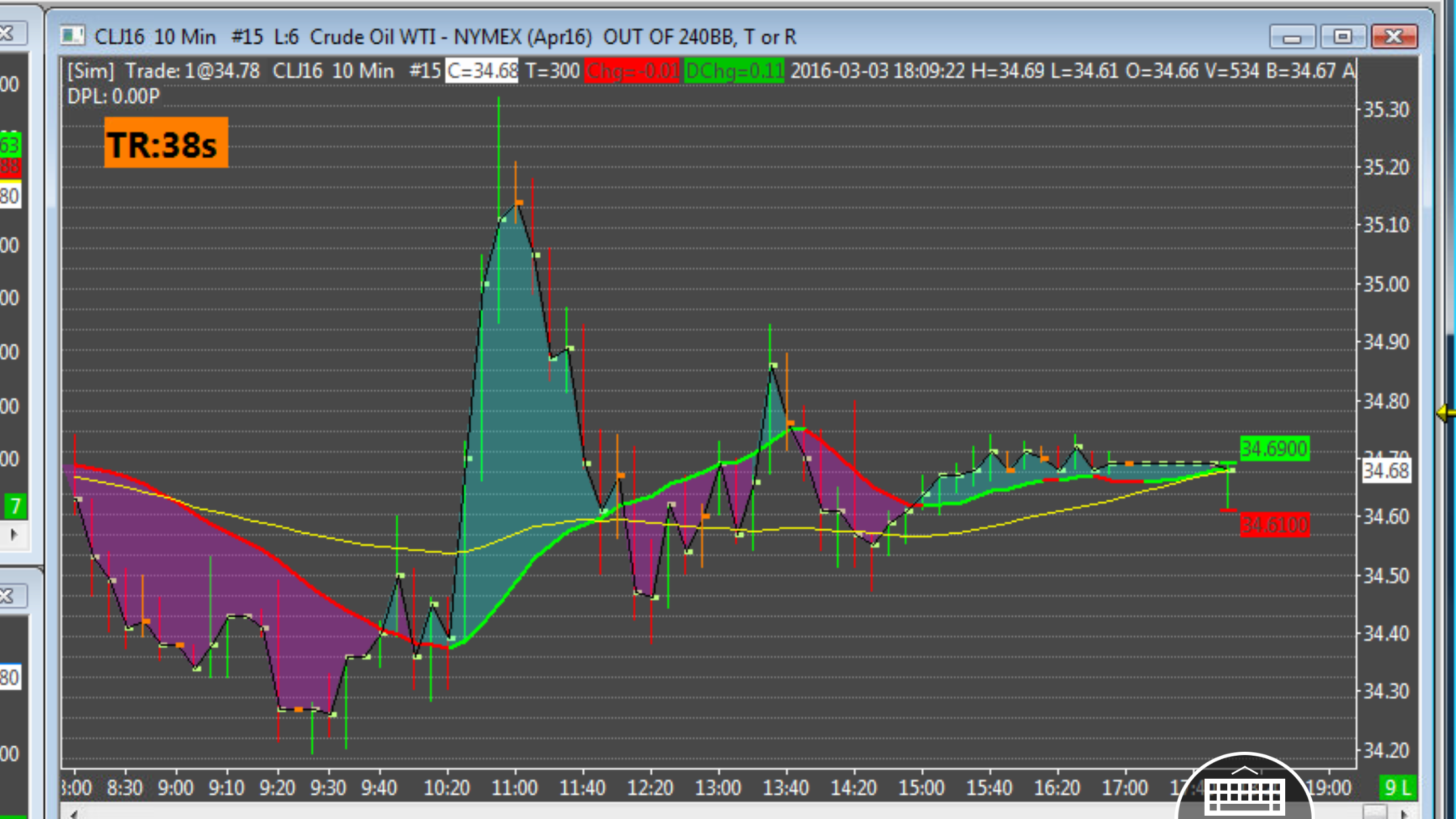

uploaded as a file, please find a picture of 10minute crude oil chart from today... you will see that it shows too many bars.
for example look between 9:10 and 9:20, there are two additional bars in the middle...
look between 9:20 and 9:30, there are two additional bars in the middle
since this is a 10 minute chart, there should be only one bar for every ten minutes...
why is that and how do I correct this?

imageCrudeOil10MinuteChartShowsTooManyBars.png / V - Attached On 2016-03-03 23:30:53 UTC - Size: 803.19 KB - 487 views

Are you using delayed data from Barchart?
Right-click before those duplicate bars and select Delete and Download Data.
Make sure that Global Settings >> Data/Trade Service Settings >> Timestamp Using Local Computer Clock is set to False.

i did the 'Right-click before those duplicate bars and select Delete and Download Data' and the problem is still the same.
i made sure that the 'Make sure that Global Settings >> Data/Trade Service Settings >> Timestamp Using Local Computer Clock is set to False'
now if i close this desktop computer and open the same sierra charts with the same barchart datafeed on my laptop, the bars look normal!! i see one bar for every 10 minutes on my laptop...
where is this setting that is changing this on my desktop?

In the instance of Sierra Chart where you have this problem, what is Global Settings >> Data/Trade Service Settings >> Intraday Data Storage Time Unit set to?
[2016-03-04 19:23:33]
User147893 - Posts: 10
1 Tick

What is the time zone that chart is showing?
[2016-03-04 20:11:58]
We checked the data and we do not see any problems with the historical data. Which means if you actually are re-downloading it , you should no longer see this problem.
We want you to delete the data file following the instructions here to make sure you are actually re-downloading the data:
Intraday Data Editor: Deleting a Data File
Date Time Of Last Edit: 2016-03-04 20:12:57
