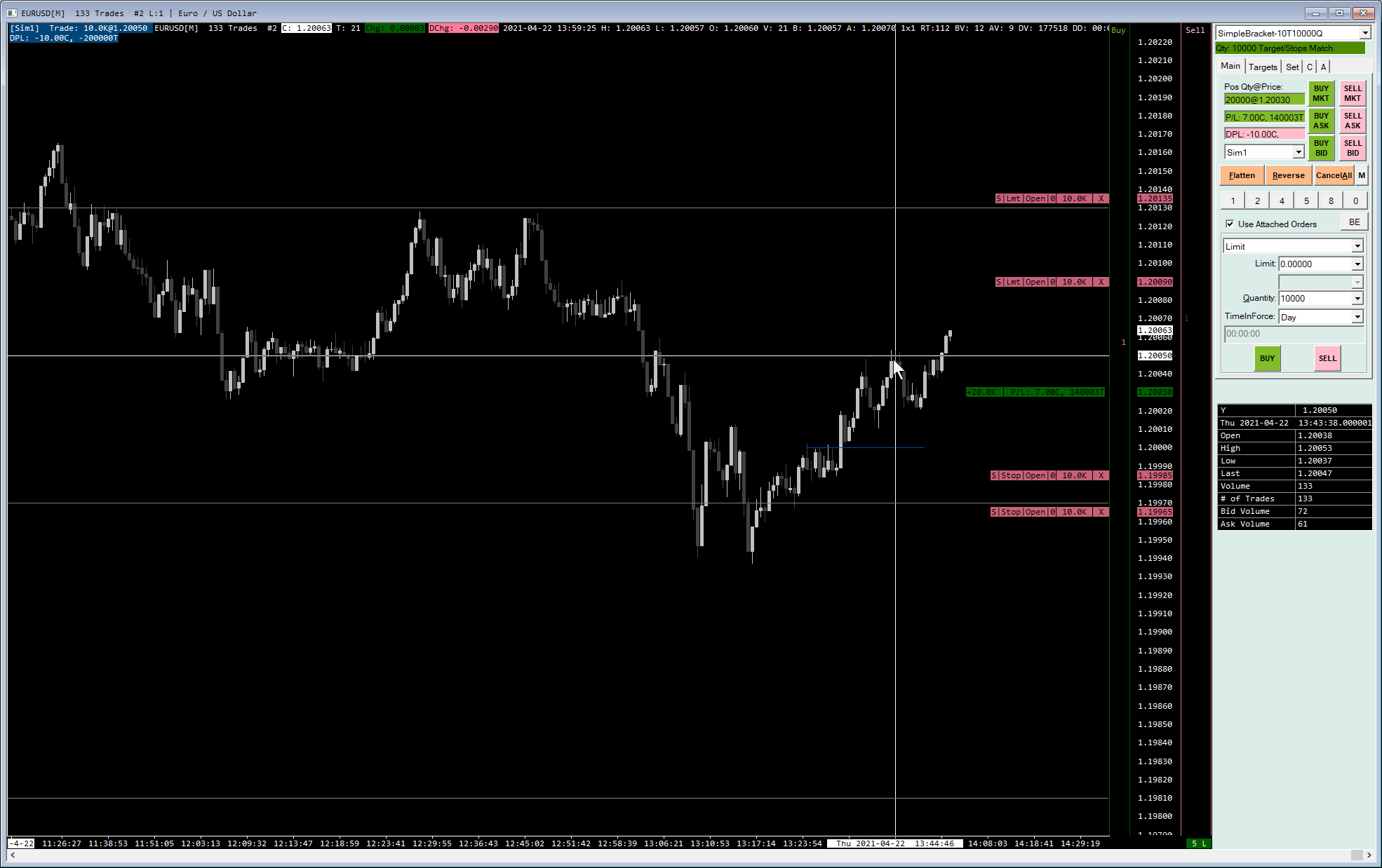

[2021-04-22 19:11:47]
User676363 - Posts: 90
I have noticed this also.
Not sure if the instructions work the way I would expect.
I see that I can update information about each symbol, but the information is 0.0001 (to the pip) but not to the pipette (0.00010)
I've attached screenshot of what I see containing two examples of the situation:
1) a blue line drawn across the candles at 1.20000. Notice how the line cuts through wicks. I am unable to align the line with the candles directly. I can only move it up 1.20005 or down to 1.19995. I cannot align it with 1.20002, for example.
2) a cursor with the cursor information box overlayed on the trade window.
Notice how the cursor shows itself in between the high and the low of the candle.
The cursor position (Y) only moves in 0.00005 increments.
Perhaps it's normal, but I think that when drawing, people would want to be able to draw right to the (0.12345) position.
Is it possible to have the cursor and drawings be precise to 0.00001 rather than 0.00005?
Thank you.
imageSierraChart_64_2021-04-22_20-59-44.png / V - Attached On 2021-04-22 19:02:24 UTC - Size: 106.09 KB - 313 views
[2021-04-23 14:01:48]
John - SC Support - Posts: 48239
The implication from what you are stating is that the Tick Size is incorrect. You would just need to adjust the Tick Size for the chart to match to the levels that the exchange is recording the data. For instance, if your Tick Size is 0.0005, then you may need to change it to 0.0001 or 0.00005. The exact value to change it to will depend on what you are seeing in your chart for the data. Refer to the following:
Chart Settings: Tick Size (Chart >> Chart Settings >> Symbol >> Symbol Settings menu)
