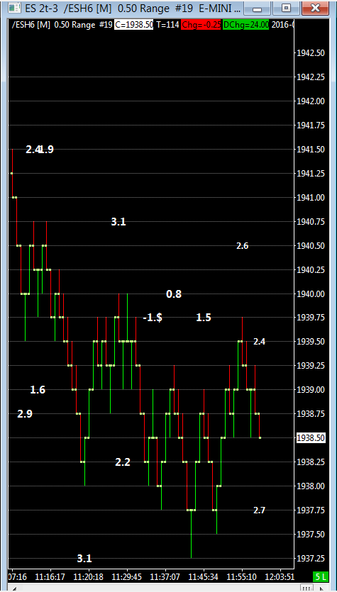

Hi, I have a custom study which prints a numeric reading at the top or bottom of bars on a chart. I have posted two charts. When I look at my charts in their auto pilot mode, I dont see some of these number as they are underneath the bottom of my chart bars. I have to customize the scaling to see them, then when the chart moves to new levels, I have to customize it again to see the new levels. Is there a way to change a setting to "see" all of this on my chart? ES 1 is a normal chart, ES 2 is what I need to see cause the numbers are cut off.
Tom

[2016-02-24 06:03:00]
Not if these are using the Text Drawing Tool.
If the study is using a Study Subgraph to output these values as text, and it has an Independent Scale, then you will always see them on the chart.
