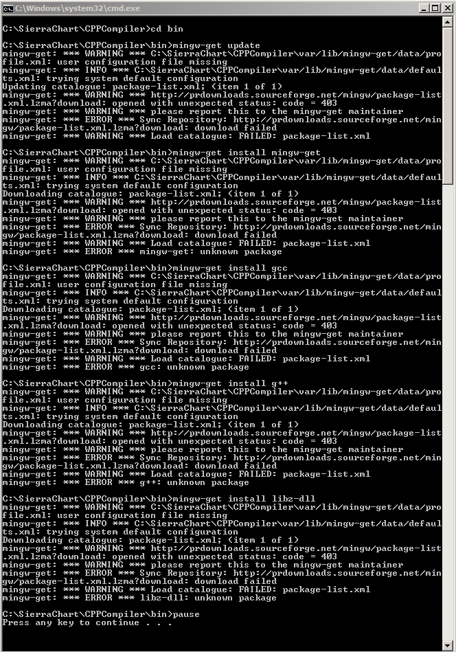

i see the compiler is installed in the SC directory but I cant seem to build any studies. And when I click on "Install Compiler" I get the error below...
imageCompiler installation error.PNG / V - Attached On 2016-07-13 16:57:42 UTC - Size: 74.73 KB - 403 views

When you build an advanced custom studies source code file, copy and paste here the text from the Build Output window so we can see what the problem is.
Those errors you see when installing the compiler might be normal and not cause a problem because sometimes there are errors which do not cause a problem. However, they do appear as though that they are a problem.

[2016-07-13 17:58:09]
For reasons which we do not know the cause of, you are having a problem installing the compiler on your system. Looks like some kind of HTTP connection issue.
