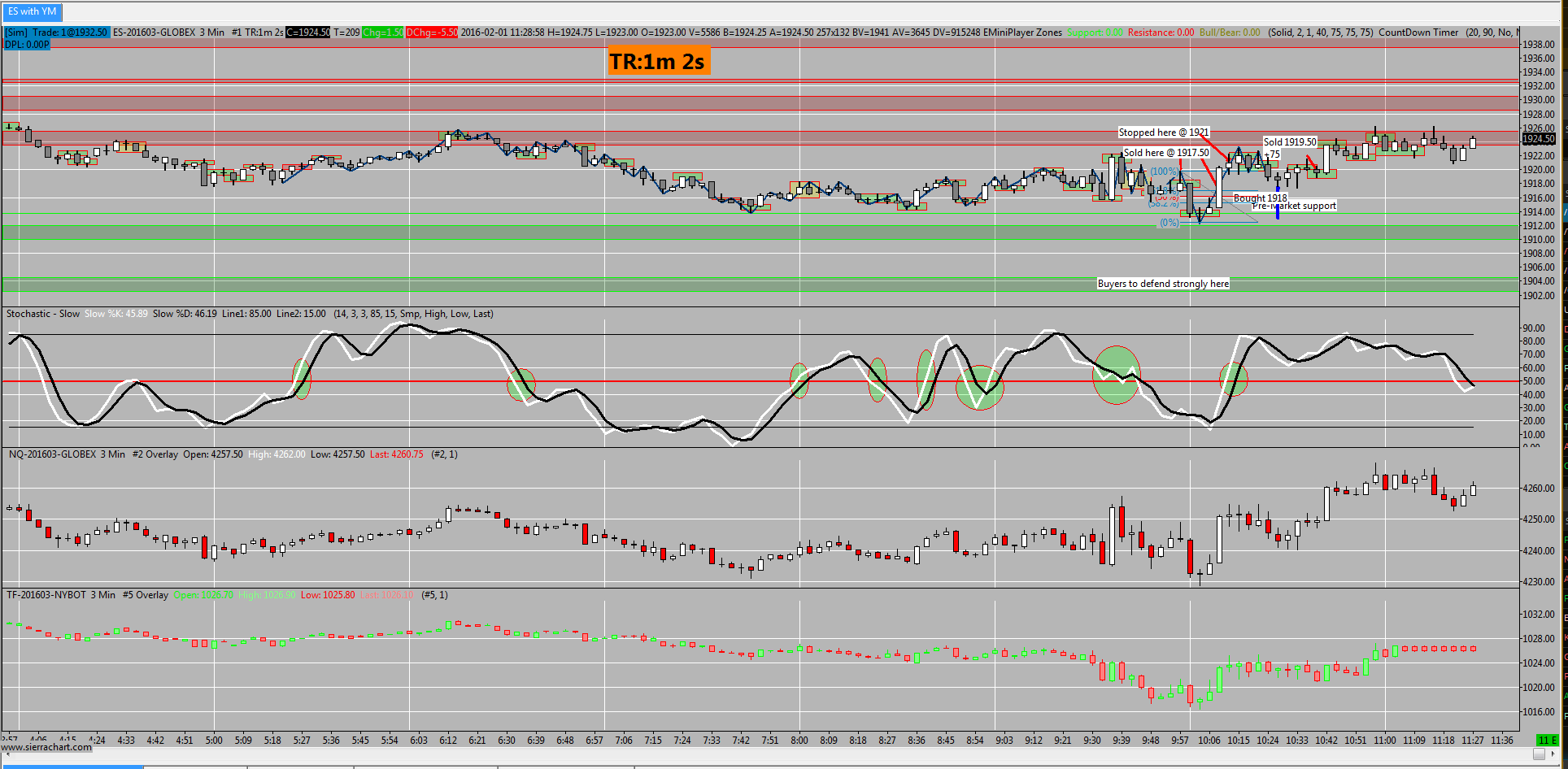

I have overlaid a subchart (/TF) onto one of my chartbooks and for some reason it shows all the data from the previous login but shows a flat line from my current login. The /TF chart that is open within the chartbook is fine and showing the current ticks/data, it just does not translate when I overlay the chart as a sub-chart.
What am I doing wrong?
here is a screen shot: http://www.sierrachart.com/image.php?l=1454344139859.png

When posting an image of the chart, it is essential to remove all unnecessary studies from it. And give us a simple image.
It is really impossible for us to say what the problem is with this little information.
We need to see an image of the source chart being overlaid onto the other chart. And we need to know the Inputs of the Overlay study being used.
So we need to see both charts again with only one of them having the Overlay study and all other studies removed. Also add the "Out of Order Timestamps Detector" study to the destination chart.
Make sure the time zone of both charts is set the same:

Sorry. The problem is with the IB data. There is something wrong at my data source. Not a Sierra Chart problem.
