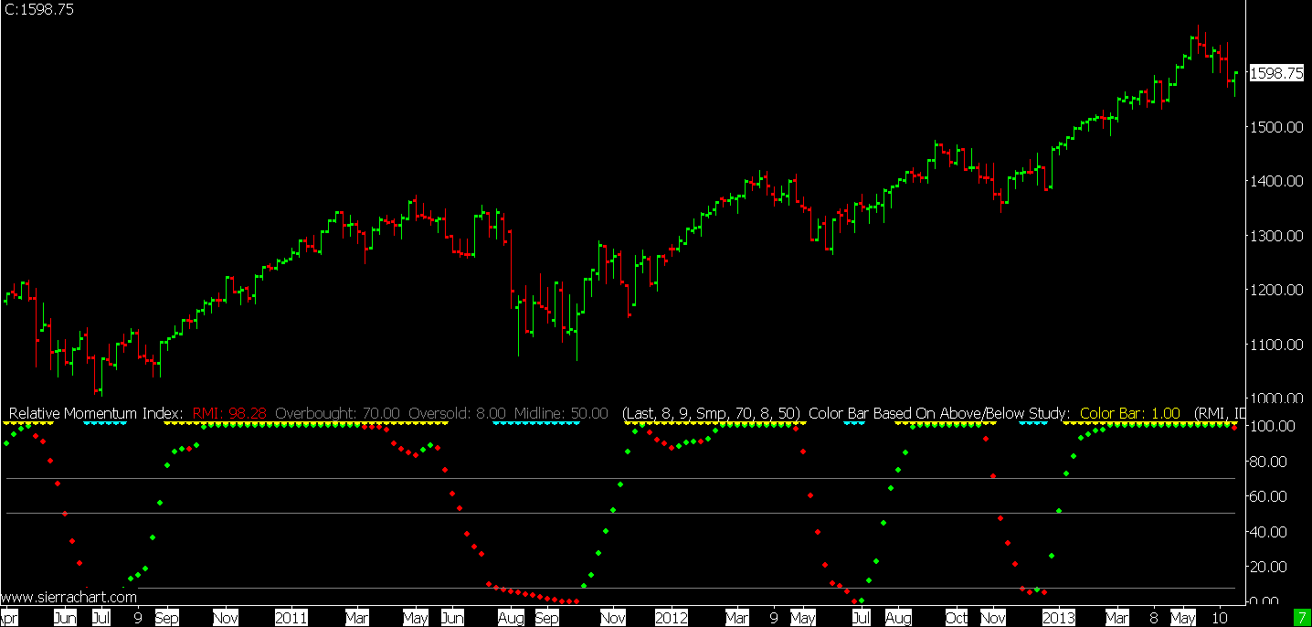

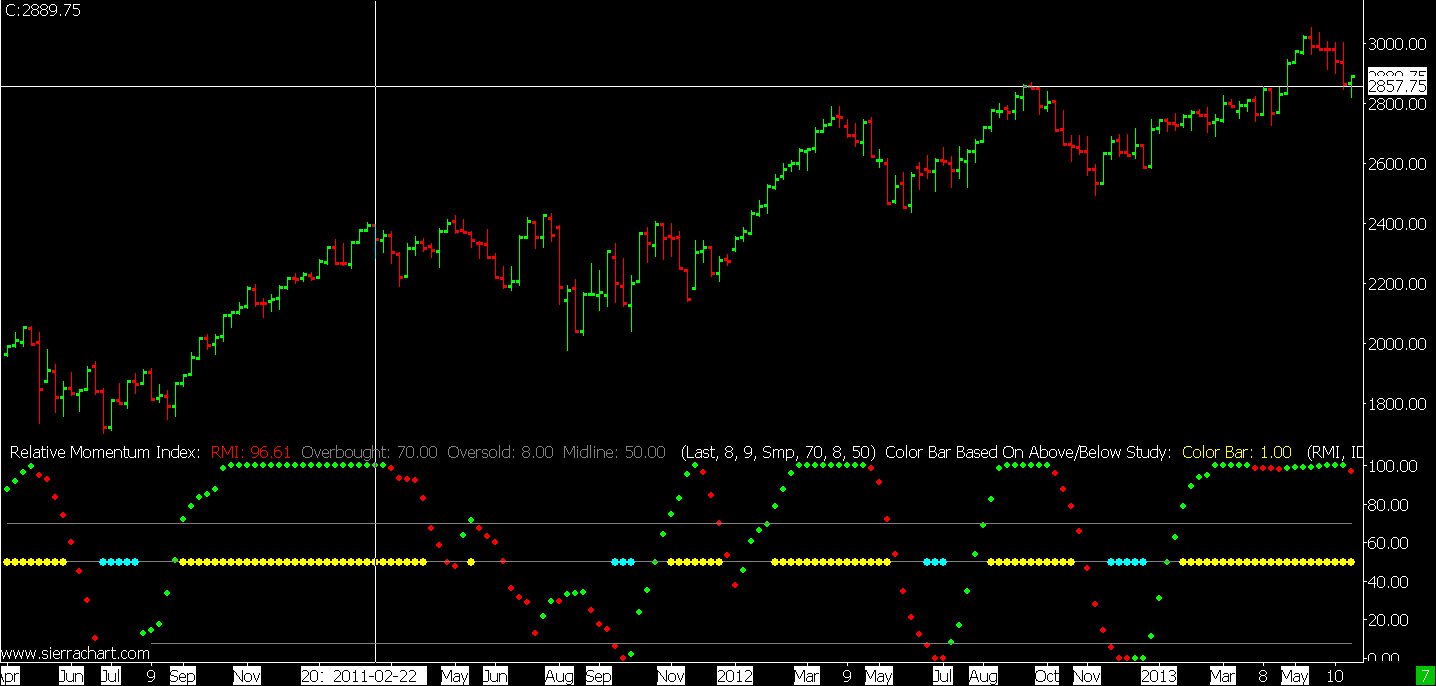

I use chart markers centered over indicators. For instance an up arrow centered over a stochastic when it is below an oversold horizontal line.
I just downloaded SC 990 and now, when I change chart symbols, the markers all go to the top of their respective region and are no longer clearly visible.
I have to reload the chart analysis template to recenter the arrows, dots, whatever. I go through a lot of charts midday and this is tedious.
There is no log entry triggered.
This has never happened before. Any ideas?

[2013-06-27 10:15:43]
James235 - Posts: 2
http://www.sierrachart.com/image.php?l=1372327906685.png
http://www.sierrachart.com/image.php?l=1372327983585.png
Here are before and after shots of Relative Momentum Index with overbought/oversold dots.
