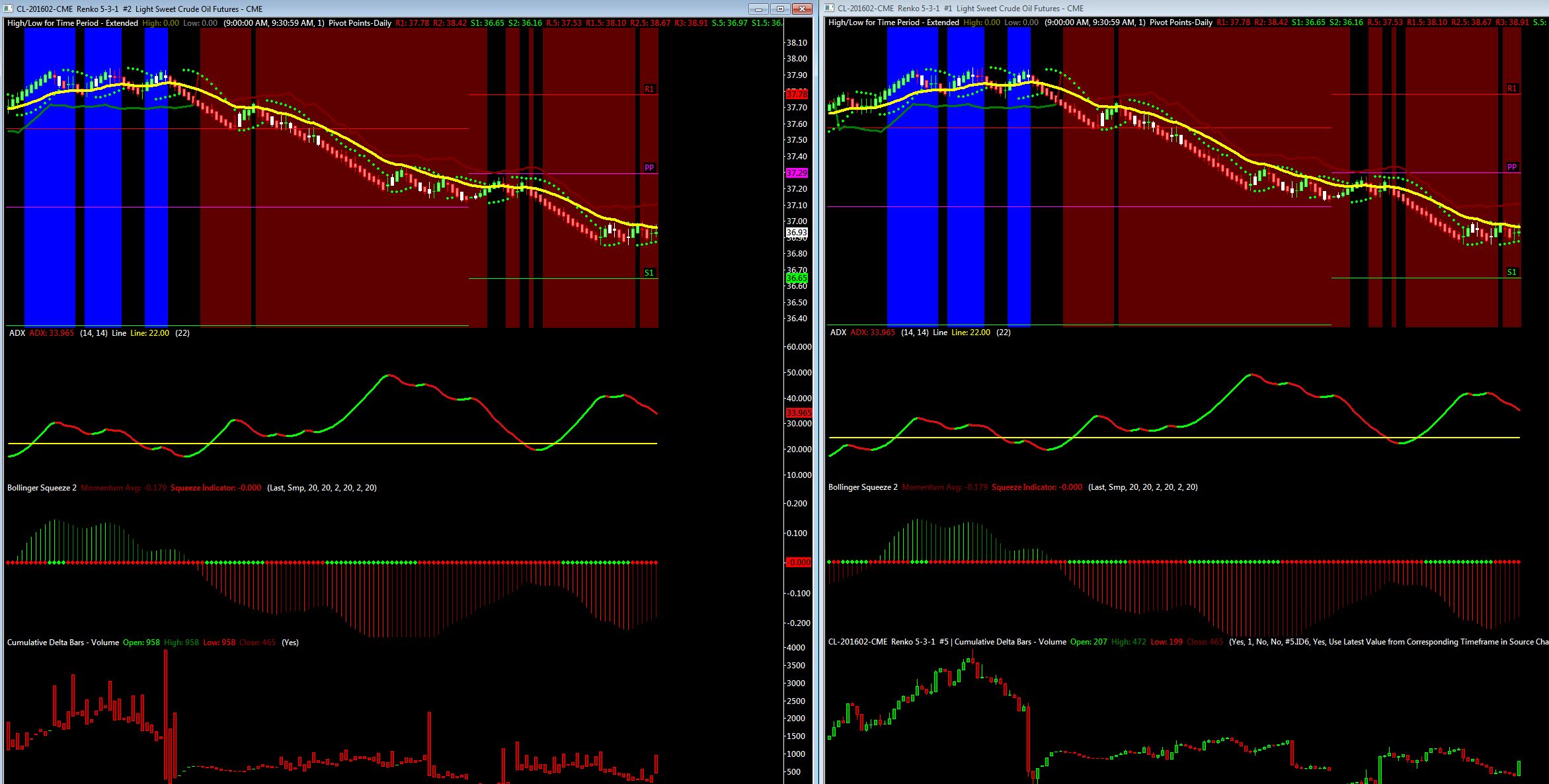

I can have Cum Delta volume as a study if i DO NOT have Heikin Aishi applied to my main chart. Works fine.
If I do, then the colors are all screwed up and even the bars dont look right
Please see attached screenshot. They are duplicate charts, both with Heikin Ashi applied to main graph
On the right, I have the Cumulative delta volume showing correctly ONLY because I have made a copy without the Heikin Ashi and have overlayed that study onto what I am showing you
On the left, Cum delta looks all whacky since i just added that study on the chart
If I remove Heikin Ashi from main graph, then all cum delta volume bars look fine
Please help

[2015-12-30 18:14:34]
This issue is already solved. You are running a significantly older version of Sierra Chart. Update following the instructions here:
https://www.sierrachart.com/index.php?page=doc/download.php#FastUpdate

[2015-12-31 10:22:17]
User80541 - Posts: 13
Thank you this worked
