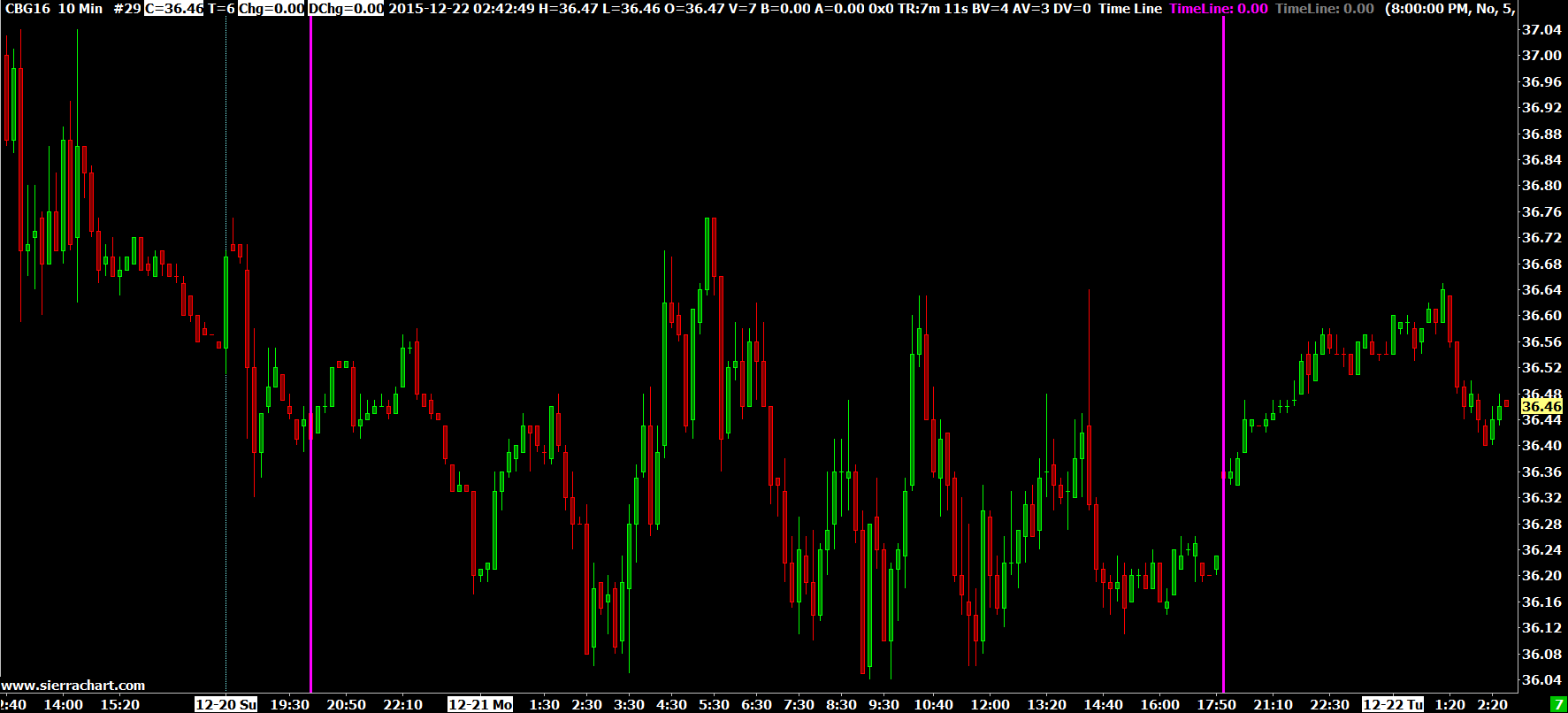

[2015-12-22 08:01:24]
It works for every day except the 18:00:00 start on Sunday.
Why would there be a problem with this? We tested it now and it works as we would totally expect:
http://www.sierrachart.com/image.php?l=1450771267509.png
[2015-12-22 08:26:41]
User13668 - Posts: 296
Re post #8.
Well you can see from your picture.
On Sunday the timeline prints at 8pm, but the session starts at 6pm on a Sunday. So I want a line plotting at 6pm on Sunday ONLY and NOT at 8pm on Sunday. But for the balance of week it needs to plot at 8pm.
Your line is correctly drawing at 8pm on Monday (which is when the session starts for each day for the balance of the trading week).
The challenge is that ICE have a number of contracts that have a DIFFERENT session time for Sunday ie it starts at 6pm whereas for the balance of the week it starts at 8pm.
CME instruments do not have this challenge as they start at the same time every day.
Ninja Trader handle this problem (from memory) by allowing you to specify session times for each day of the week.

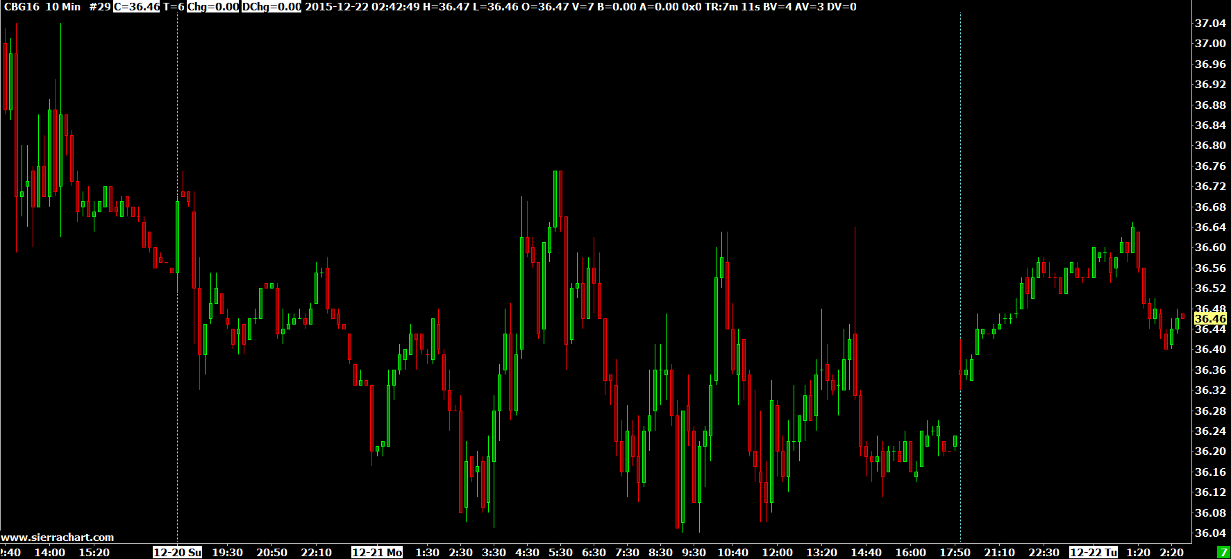

[2015-12-22 08:33:03]
We fail to see any practical problem here:
http://www.sierrachart.com/image.php?l=1450773138327.png
We removed the Time Line study and the vertical lines are drawn at the times you require, by using the Vertical Grid at the Start of Trading Day.

[2015-12-22 08:37:27]
Re post #11.
Ah okay, I will try that. I did not think of using Vertical Grid. I have been using Time Line study to plot a vertical line at start of trading day.

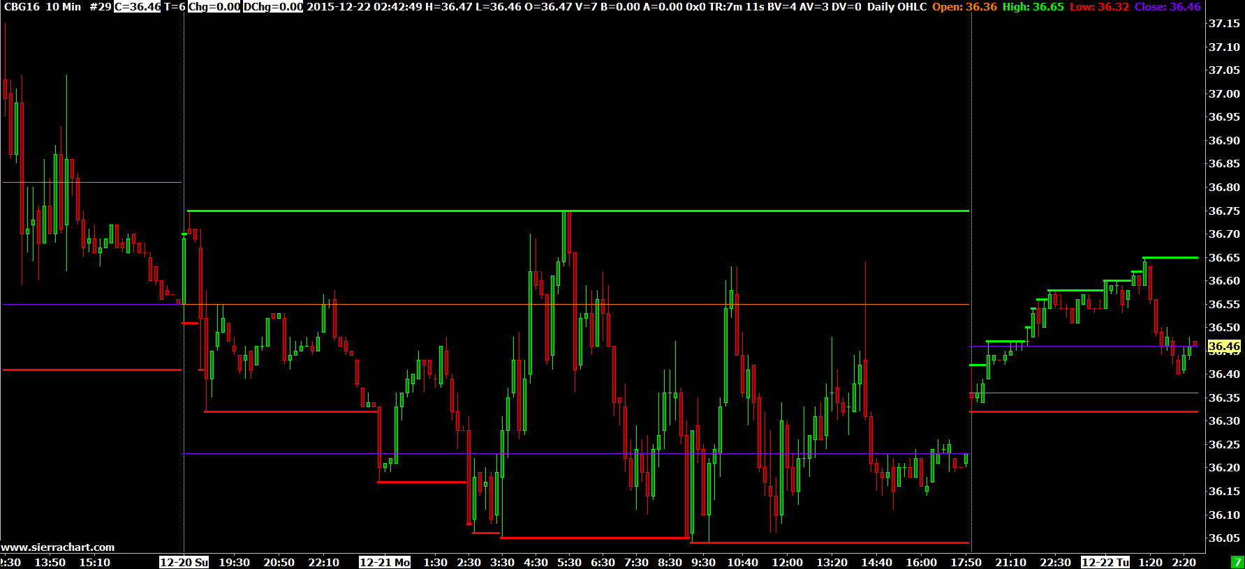

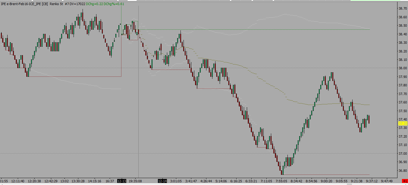

But look at the attached:
I like a staircase plot style on my chart of the daily high and low as the day plays out. For this picture you can see the true high of the day is being incorrectly plotted as it is ignoring the high made in the first two hours on Sunday night as it deems that to be in a 'Sunday' session.
Secondly a study like a Daily VWAP (also shown) is wrong for Monday as it is ignoring trades (ie volume) from the first two hours on Sunday.
imageSCCapture.PNG / V - Attached On 2015-12-22 08:51:47 UTC - Size: 35.63 KB - 466 views
[2015-12-22 08:58:57]
The Daily OHLC study works correct when using a Start Time of 18:00:
http://www.sierrachart.com/image.php?l=1450774687297.png
The Volume We did Average Price study will also be correct.
