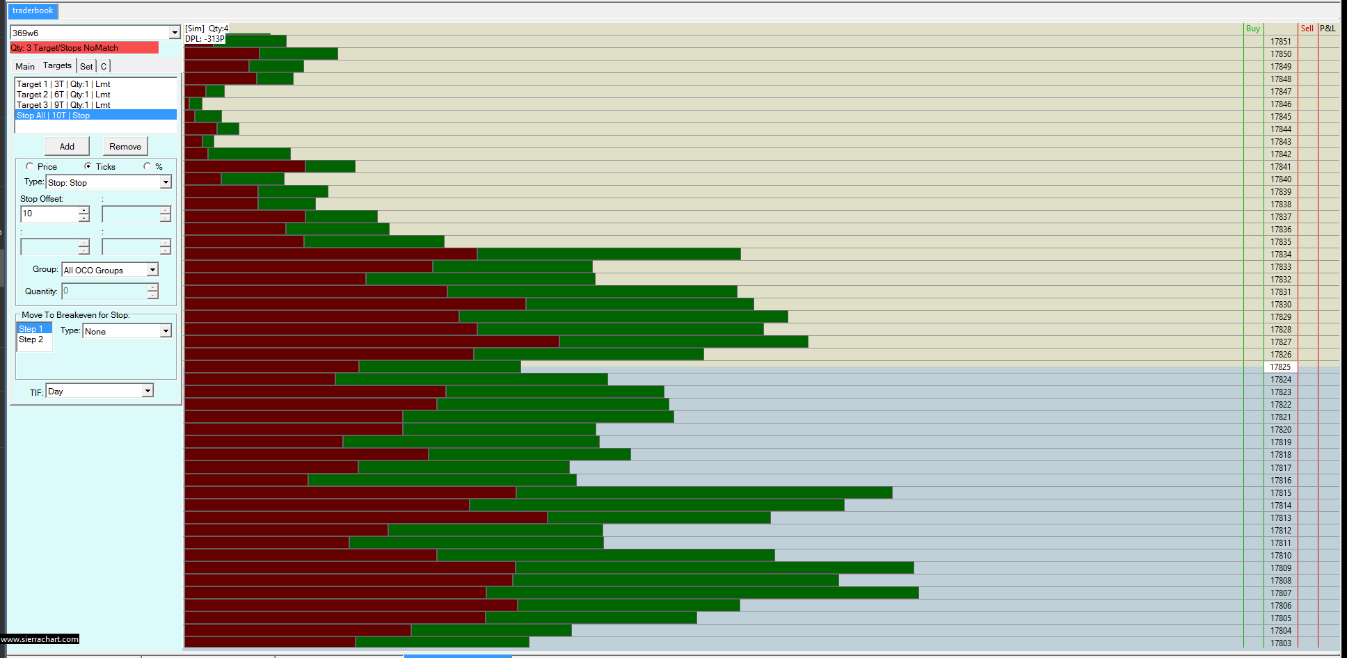

http://www.sierrachart.com/image.php?l=1449440214906.png
I did that and its still not working. I included a pic of the DOM.
[2015-12-06 22:47:52]
The Targets tab is set correctly. What is the specific problem?
You can disregard the notice at the top of the Trade Window about there being a quantity mismatch because that is not going to matter in this case. You will still be able to submit the order with its Attached Orders.
[2015-12-06 23:25:26]
User638756 - Posts: 52
Ok your right, it went thru (thanks!) . I put a sim trade on with it and 2 targets got hit and 1 did not, the order got stopped out but it didnt stop out the rest of the order even tho the oco group is all.
[2015-12-07 00:13:01]
OK in that particular case you need to use 4 separate Stops each set to a Quantity of 1. Each one needs to use a separate OCO Group. Use 1 through 4.
