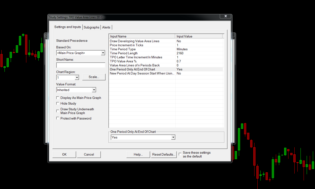

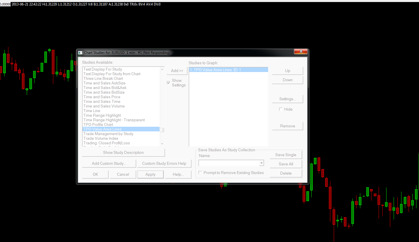

[2013-06-22 04:11:37]
dst656 - Posts: 16
here are two pics of my screen to see the settings and the chart freezing up. this is on a 1 minute chart.
imageTPO 1.PNG / V - Attached On 2013-06-22 04:11:10 UTC - Size: 71.28 KB - 885 views
imageTPO 2.PNG / V - Attached On 2013-06-22 04:11:19 UTC - Size: 71.8 KB - 835 views
[2013-06-22 07:55:48]
This is interesting. You are the first one to use time period of minutes that exceeds 1 day. This is currently unsupported which is resulting in a calculation problem which is taking a long time. We are resolving this.
[2013-06-22 11:00:54]
Please update Sierra Chart by selecting Help >> Download Pre-release.
This issue is resolved in the latest revision.

[2013-06-22 20:09:05]
This problem has been resolved. Please follow our instructions and update to the latest revision by selecting Help >> Download Prerelease. The version number did not change. You will not have this problem any longer.
