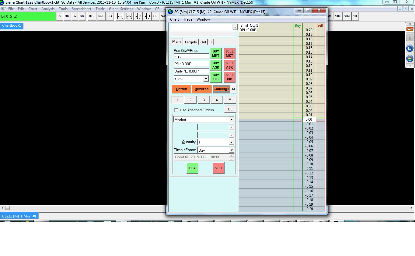

I'm connected, but not able to use DOM.
View Count: 1644
[2015-11-10 15:44:55]
User779963 - Posts: 10
Please, could you help me?
Any trouble with configuration?
imageSIERRA - DOM.jpg / V - Attached On 2015-11-10 15:43:40 UTC - Size: 205.3 KB - 464 views

[2015-11-10 18:52:09]
Please , see attached document!
May this issue be related to firewall?

[2015-11-10 19:12:45]
Yes, a firewall is the problem. Refer to the instructions here to use Port 80:

[2015-11-10 20:06:53]
Therefore, a firewall is blocking the connection. Please contact your Internet Service Provider about this. This is the relevant documentation:
Historical Intraday Data (Missing Data / Download Errors / Viewing More Data): Error when Downloading Historical Intraday Data from the Sierra Chart Historical Data Server
However, to confirm the problem, we must see a copy of the Message Log provided by following these instructions only:

When I open the DOM, it doesn't show the prices..
If so, then you need to select Help >> Accept Remote Assistance.
You will get a Team viewer window with an ID number and password. Start an Account Support ticket and provide us that information:
https://www.sierrachart.com/usercp.php?page=SupportTickets

https://www.sierrachart.com/index.php?page=doc/download.php#FastUpdate
You need to use Help >> Download Prerelease.
