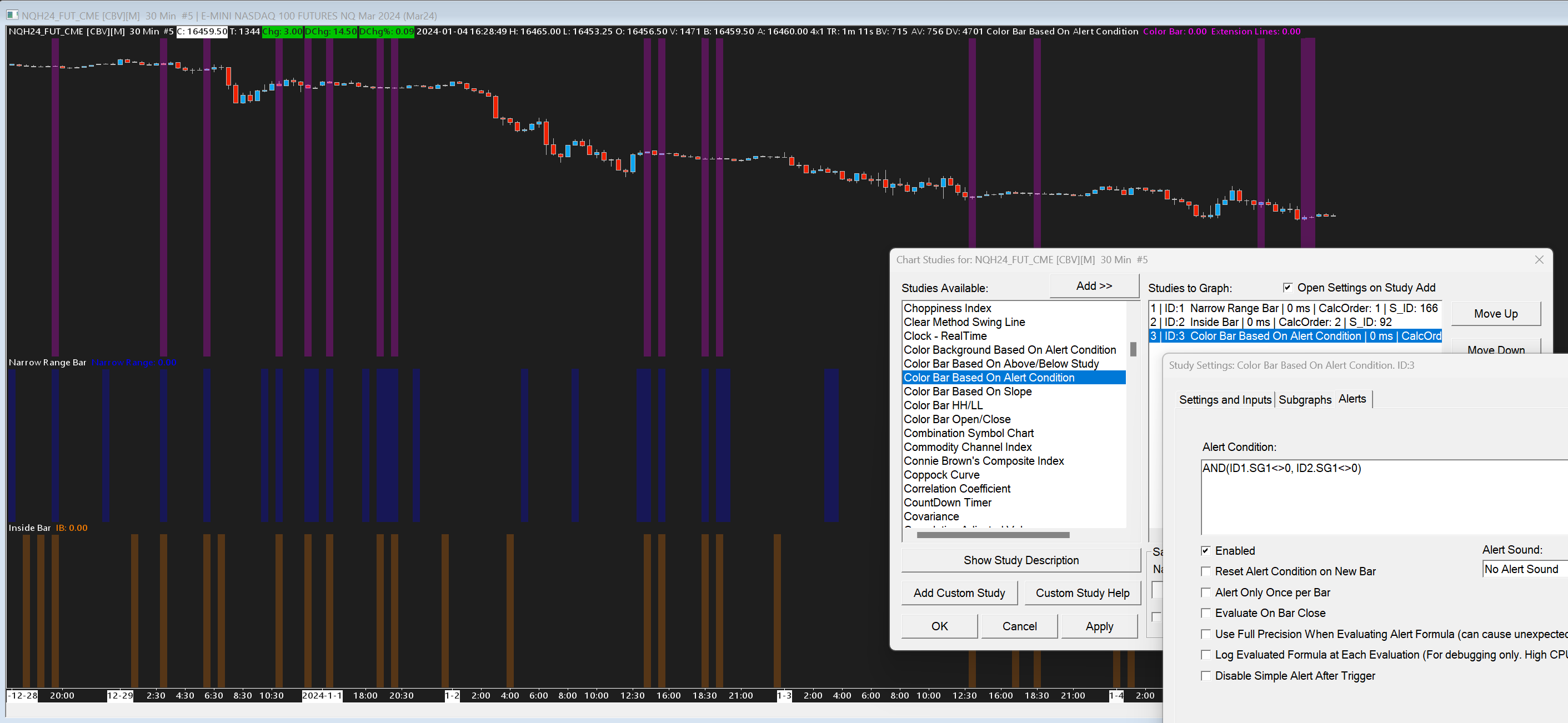

User719512 - Posts: 543
You can also do this with Color Bar Based On Alert Condition.
I set the SGs for all to Background Transparent.
AND(ID1.SG1<>0, ID2.SG1<>0)
See attached screenshot
imageID NR CBBOAC.png / V - Attached On 2024-01-05 00:31:16 UTC - Size: 198.32 KB - 223 views
