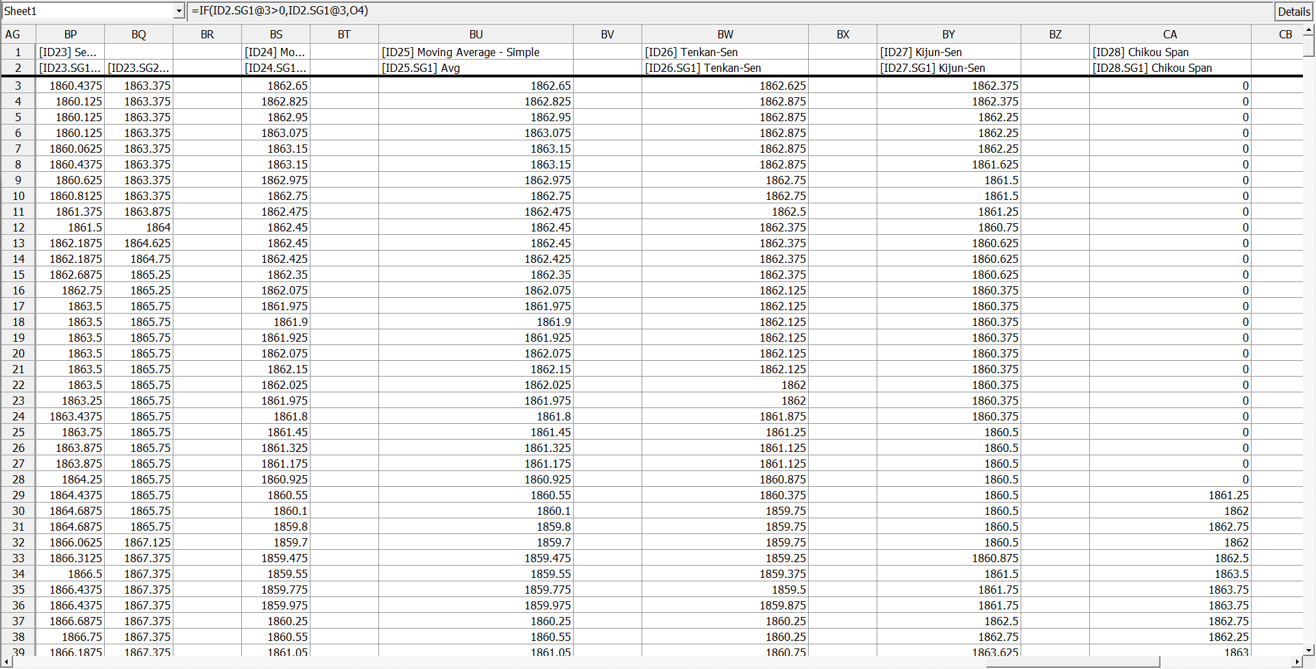

http://www.sierrachart.com/image.php?l=1453574855118.png
And can you please explain what are all these Moving averages, Tenkan sen etc. numbers? I dont have any such indicator on my chart (pls see attached file also)
Thanks!
Date Time Of Last Edit: 2016-01-23 19:17:14
imageerrrrrrrr.png / V - Attached On 2016-01-23 18:55:04 UTC - Size: 102.77 KB - 561 views
[2016-01-23 21:52:34]
Sawtooth - Posts: 4361
Go to the ATRSwingHL spreadsheet settings and:
-Set the Chart Region to 1
-Set the Draw Styles of SG2, SG3, SG4 to Ignore
Did you edit the formulas in cells O3, P3, S3 to the ID#s given to your ATR and Swing H&L studies?
I forgot to delete the data in columns above AD. That is left over from testing my instructions on a chart with other studies.
To remove that superfluous data, highlight columns AA and above and press DEL.

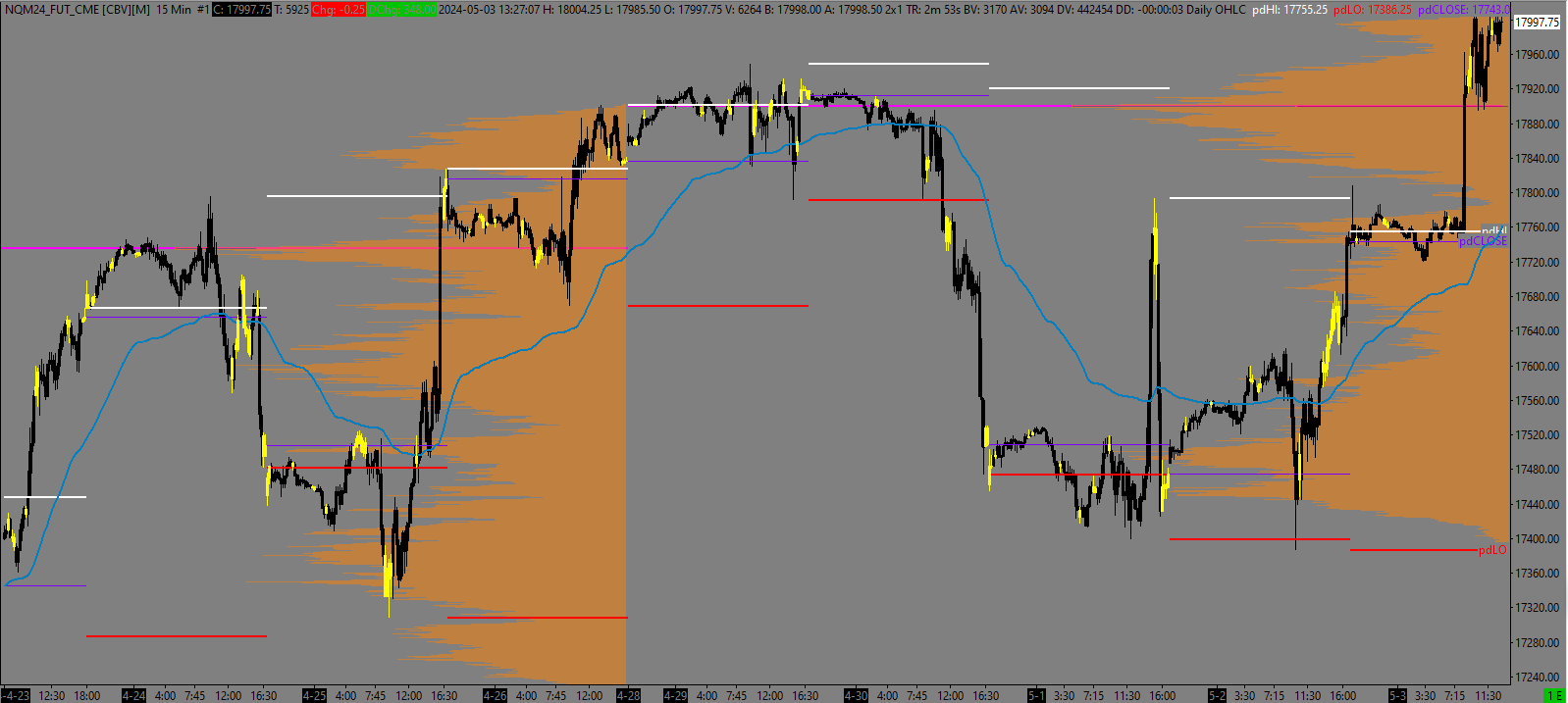

Hey Sawtooth, so I think I finally got it working correctly. a couple questions if you have the time
The length I have for SwingHL study is set to 1 because if I increase it, it ends ups coloring all the bars. is that how it's suppose to work?
The length I have for ATR is at 2 because increasing it will also color all the bars. Is that normal as well?
Also is there a way to select different colors (2 colors, swing and low)?
imageScreenshot 2024-05-03 132717.png / V - Attached On 2024-05-03 17:31:14 UTC - Size: 54.56 KB - 301 views
[2024-05-03 20:03:43]
Not necessarily, but some combinations of setting will color all of the bars.
No, because this study is looking at the Swing HL range.
