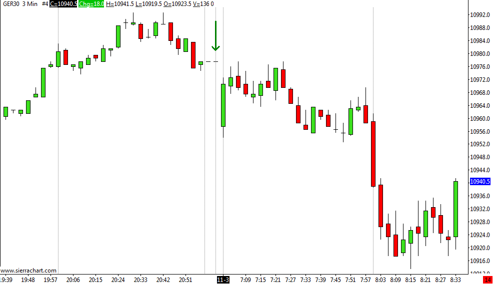

I have just logged on and updated the data and there are 2 rogue prints on GER30 at 21.21 and 22.00 GMT last night (02/11). Is the best solution to keep reporting these for you to deal with it on your end or to change the session times for this symbol?

We do not see these.
Provide an image of the chart showing them, by following these instructions:
[2015-11-03 09:18:43]
User842703 - Posts: 55
http://www.sierrachart.com/image.php?l=1446542268588.png

[2015-11-05 12:01:28]
There are 2 odd prints @ 21.00 and 21.03 GMT yesterday for GER30 and 21.00 and 21.06 GMT for Uk100. FRA40 is ok.
Have tried the Delete and Download function but doesn't do anything.
[2015-11-05 17:27:21]
We had looked into this. The problem is FXCM is transmitting data at these times which is causing this. If these are outside of the normal session times, then adjust the Session Times in Chart Settings to filter these out. Refer to:
http://www.sierrachart.com/index.php?page=doc/doc_SessionTimes.php
We will still see if there is anything we can do.
