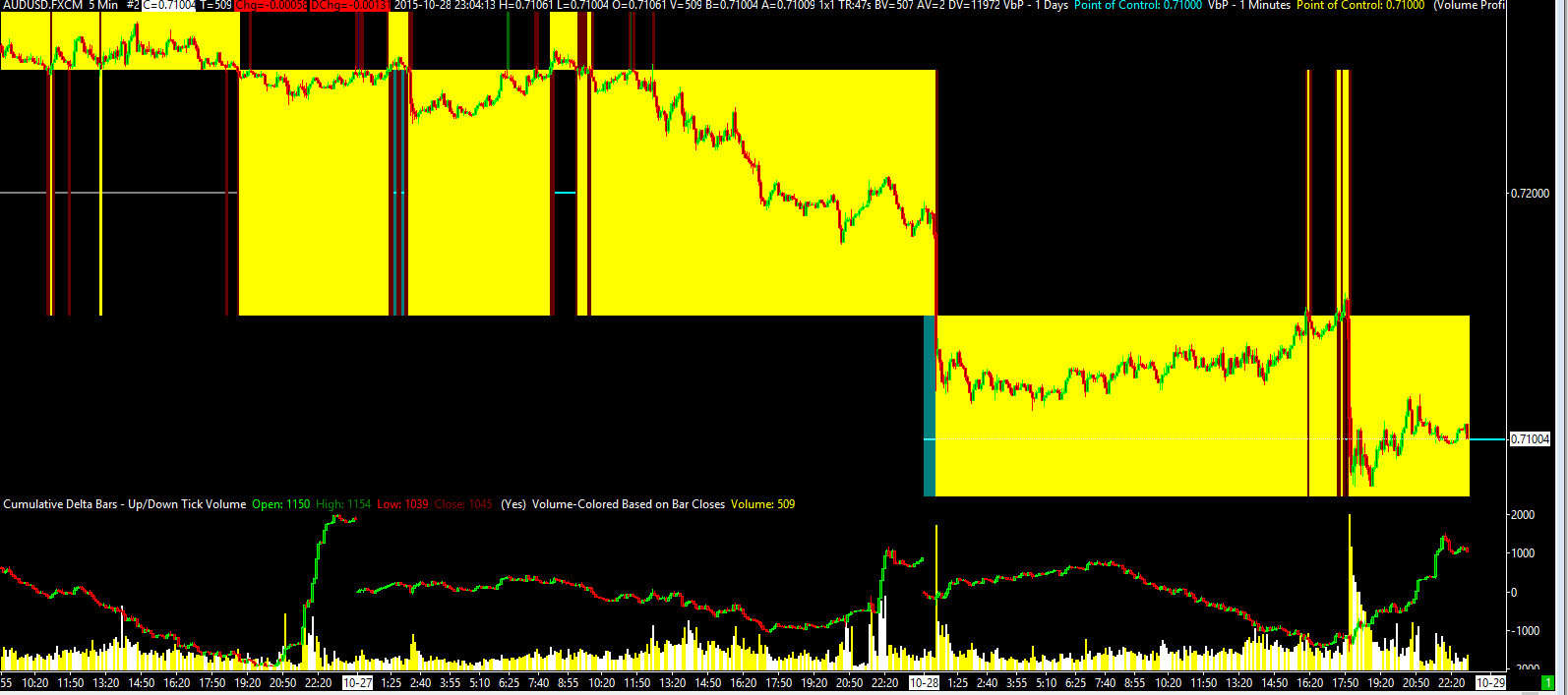

Hi guys,
GU, AU, EAUD, and GAUD are not working with my volume by price indicators. Is there a way to fix it. My EU works but those dont. I attached a screeen shot. It looks like price may be the matter.
imageProblems_with_AU.png / V - Attached On 2015-10-28 23:04:49 UTC - Size: 43.34 KB - 415 views
[2015-10-29 04:37:54]
The problem is the Tick Size in the Chart >> Chart Settings is not set correctly. Refer to this page for information about that setting:
Chart Settings: Tick Size (Chart >> Chart Settings >> Symbol >> Symbol Settings menu)
We still have yet to add the symbol settings for these particular IQ Feed FXCM symbols.

[2015-10-30 01:30:27]
The FXCM Forex symbols have all been added now for IQ Feed.
Follow the instructions here to Update the symbol settings:
Global Symbol Settings: Update Symbol Settings
You will see them in File >> Find Symbol >> Forex.
