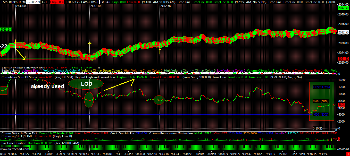

Is there a setting to change to be able to see the levels constantly(%, and price) on the retracement tool?
When I use the tool on a zoomed out chart, then zoom in, the levels (whether right or left) disappear and the only way to see the level amounts (and not just the line) is to zoom out every time. This becomes arduous when checking several times.

[2015-10-28 02:54:33]
Crtfyd - Posts: 310
Sorry, yes I mean the Price retracement tool. 1st pic I can see levels on right (I highlighted them).

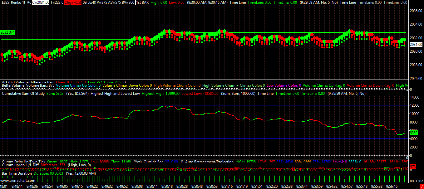

2nd picture after zoom I would hope they stay on right (adjust to stay seen) if you zoom in past the drawing level.

[2015-10-29 04:26:15]
Right-click on the Price Retracement drawing and select Chart Drawing Properties:
Chart Drawing Tools: Chart Drawing Properties
Enable Options >> Extend Right. That will solve the problem.
