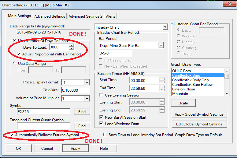

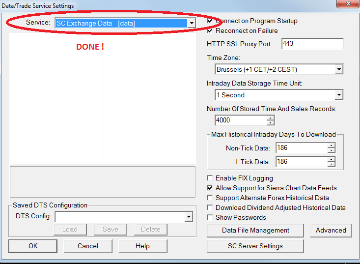

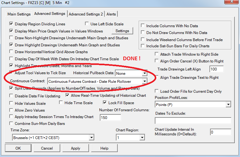

[2015-10-15 10:35:26]
Forward - Posts: 68
I followed the setting that you indicate but the historical data continue to be as before until 2015-04-02

[2015-10-15 17:29:51]
Follow the instructions here to Show the Rollover Dates:
https://www.sierrachart.com/index.php?page=doc/doc_ContinuousFuturesContractCharts.html#DisplayingRolloverDatesContractMonths
Set the Continuous Futures Contract option to Date Rule Rollover. And not Volume Based Rollover.
If you still notice a problem, follow the instructions here to re-download the data:
https://www.sierrachart.com/index.php?page=doc/doc_ContinuousFuturesContractCharts.html#ReDownloading
If you notice a problem, scroll the chart to where there is a problem and follow these instructions to provide an image of the chart:

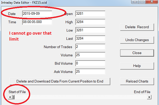

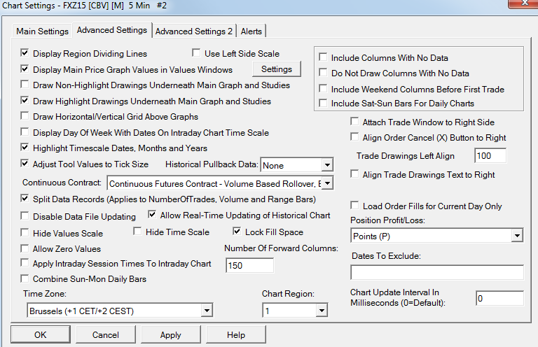

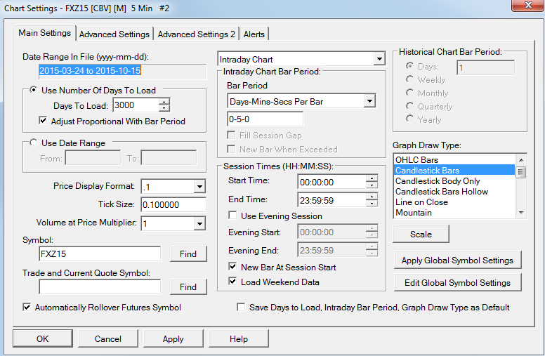

[2015-10-16 07:03:41]
Forward - Posts: 68
I believe to have followed your instructions correctly.
I have also re-downloaded everything.
Please check my setting from the pics.
I don't understand what is wrong .

[2015-10-16 07:20:00]
The last image you posted is not relevant because that only shows the first date-time of the current contract.
Set the chart bars to 480 minutes per bar, and scroll the chart to where you see something wrong.
Let us know what is wrong and post an image of the chart by following these instructions:
You must also enable Chart >> Show Rollover Dates for us.

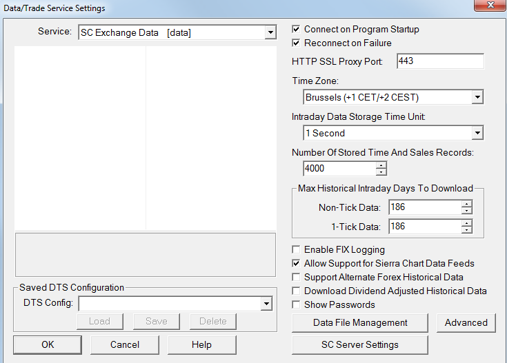

Hello, i followed the instructions and now i see the Real Time Data, but i have not any long historical data. Just 2015 years. I setted everything how you say... but nothing )-:
[2015-10-20 10:04:42]
For long-term historical futures data, follow the instructions on the Continuous Futures Contract Charts page:
First, perform a Full Reset of the Symbol Settings as explained here:
https://www.sierrachart.com/index.php?page=doc/doc_GlobalSymbolSettings.php#FullResetSymbolSettingsSteps
If you still have a problem, let us know and we will give you the procedure to provide us the Message Log.
