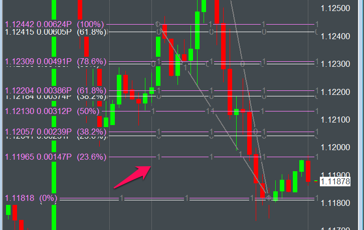

boogybren - Posts: 9
When you have two drawings close to each other and you double click on one to adjust it, sometimes it selects both drawings and labels them 0, 1 etc...
Is there a way to select drawing 0 for example when it gets into this state as to suggest to the program that is the drawing you wish to adjust?
Brenden
imagedrawing.adjustment.png / V - Attached On 2015-10-06 00:37:52 UTC - Size: 32.2 KB - 570 views
[2015-10-06 03:55:04]
Refer to the documentation here about this:
http://www.sierrachart.com/index.php?page=doc/doc_Tools.html#AdjustChartDrawing
Refer to the subsection about converging drawings.
